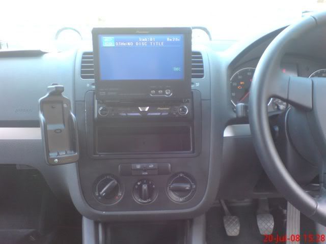

This won't help you at all but would you mind taking some pictures when you're done, please?
I've been toying with the idea of upgrading my MK5's system for ages and I'd love to see what the Pioneer unit looks like in there.

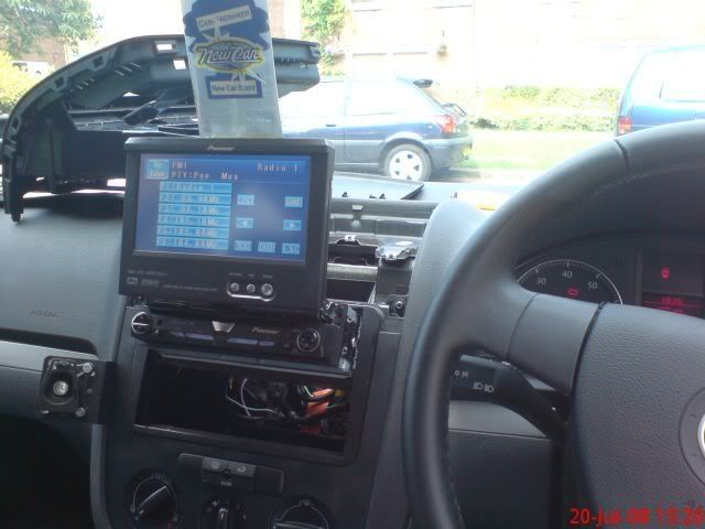

There was a wire running to the fuse box which I connected to the ignition live for the head unit. It seems to only switch on with the key now
I will do later :)
