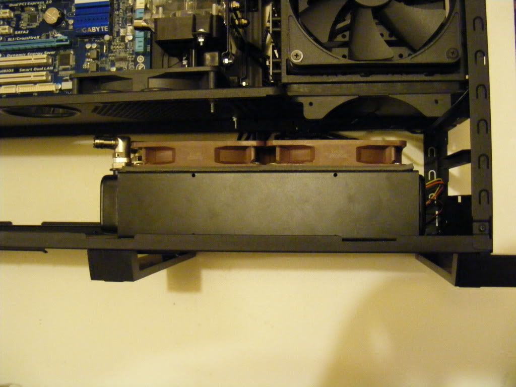

A 120.2 will fit in the bottom section, but needs the lower hdd cage removed by drilling out the rivets. I`ve got some pictures of mine at home I can post up later for you.

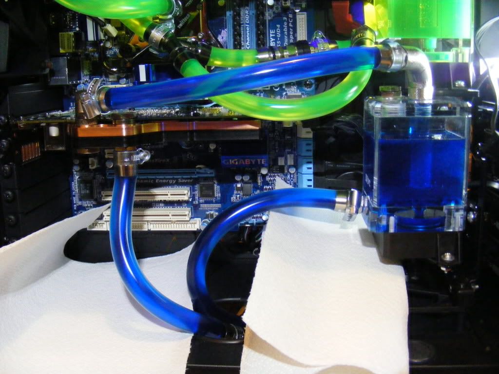

I decided to drill a single larger diameter hole in the shelf, rather than route the tubing through the two that are there already. I used 90 degree fittings at the radiator as there isn`t that much space available once a thick radiator is in there.
I also moved the stock fan to the upper face of the shelf.

Thought I had more pictures, but these show what it looks like with the lower hdd bay out. From memory, 6 rivets need drilled out and 2 need to be re-fitted to keep the shelf attached to the front panel.
And the hole I drilled for the hoses
Hope these help.:)

demonoid-gnome, wow thanks for the pics really gives a better idea. So the tools ill need are a dremel, pop rivits and gun and a jogsaw. I need to be sure i have everything as ill be doing this at night and really do only have 2 evenings max to complete as doing at my friends.

Depending on where you locate your radiator, you might only get 4 screws into solid material but that`s enough to keep it in place. I left all the original perforations in place and used a holesaw to remove a suitable amount of the bottom of the case.
You`ll need some small drill bits to drill out the rivets and radiator mounting holes, but sounds like you`ve got the rest covered.:D If you`re cutting a hole in the shelf for tube routing, some rubber blowhole trim tidies the edge up nicely.

When you`re bleeding the air bubbles out, it`s helpful if you can insert something like a pci slot blanking plate through the filling point to interrupt the flow. The plastic 90 degree bends you see in the pic are right over the pump inlet and air bubbles just get dragged right through if you don`t. It`s not essential but will improve the time taken to bleed it fully.
