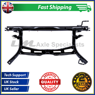

New subframe will cost around £200 and four hours labour to fit
Interesting that they didn't mention this as an option.

For some reason a lot of places don't rush to do subframe replacements - you are probably talking more like £400 for the hardware and 8 hours labour (at probably upwards of £75/h) unless you get more involved and source the subframe yourself, etc.

I needed a new subframe for my Corsa (common problem with them rusting), bought one of ebay at the request of my garage and they fitted it. Didn't take too long and in the grand scheme of things wasn't that expensive either, although it could clearly vary by manufacturer and model.
