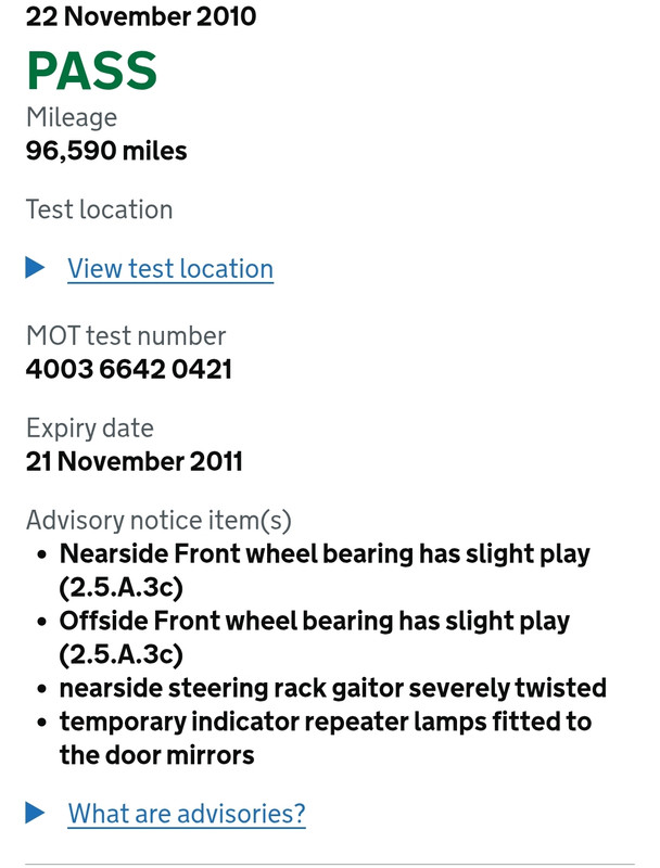

I had to temporarily cable tie some Mondeo side repeaters to my Manta because someone had replaced the wings with pre-86 ones and I realised about a week before the MOT
Lol, but why even advise it though?

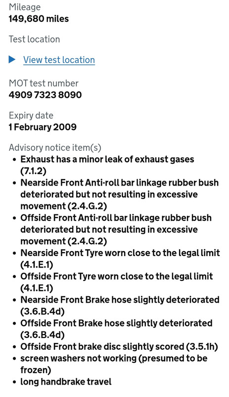

This is the same guy who tested my Volvo on a day when it was minus ten and said "Windscreen washers inoperative, presumed frozen" and he showed the the washer bottle which was literally a solid block of ice, so I think he was just one of those people.
Loved an advisory did this bloke.
It can get a bit daft, but to be fair, the person presenting a car for an MOT has to make sure sure all items are working and are testable, and if they're not then don't expect a pass.
