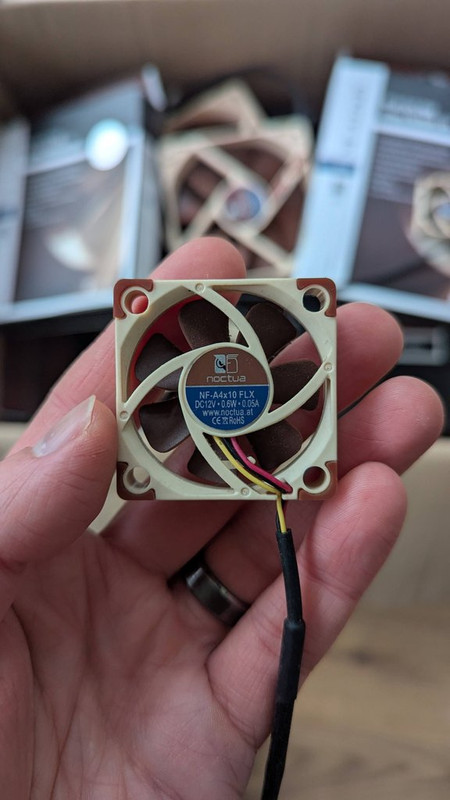

Had a rummage and I'd somehow completely forgotten about my Noctua treasure trove (getting old I presume!). Anyways there was a couple 40mm fans in there, so I'm going to see what I can do with one of them tonight. Failing that, one of the 80mm ones - might be easier to attach somewhere.

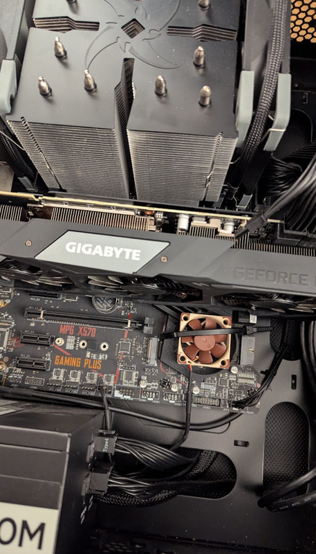

Well I think we're in business. The heatsink is raised in a few parts of the motherboard, so I was able to slip a cable tie underneath.
Thanks again for the replies, it seems like an obvious solution in hindsight to just slap on a larger fan rather than source a perfect fit / replica of the original.
All is quiet again in the office and I am happy!
