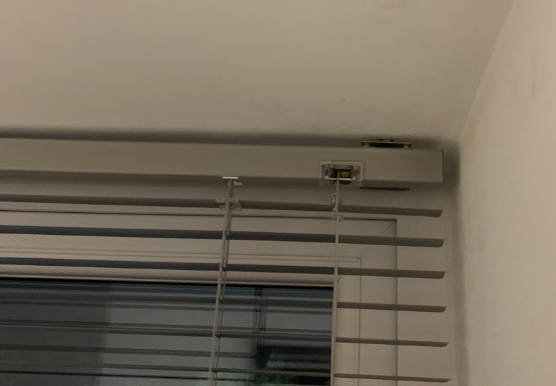

Part of the reasoning behind going with a motor was I don't like the idea of applying downwards force to raise/lower a blind. It isn't good for these types of walls (imo) and has already resulted in our bedroom one coming off on one bracket. Rather than getting it fixed, I thought I'd just get them replaced. That didn't work out as planned obviously :D
If your previous blind pulled out of the top "beam" them it wasn't fixed right... You need to use long screws to reach into the wooden beam.and not just the plaster

I’ll get a pic of the issue later today as I’m heading into work.
My flat came with these stock blinds and it is the bracket that has essentially come off the recess. I assume the fitters used a crappy rawlplug. I couldn’t see a way to remove the blinds from the bracket so I could further investigate but the chap who came in to do the measurements showed me how.
Since I’ve no expertise dealing with plasterboard I wasn’t sure how to deal with such a ‘simple’ issue.
Edit: Update with a pic. The blinds salesman showed me how I can uncouple the blind from that bracket so I'll likely look at this after I visit his showroom this weekend. I'm in two minds here really.
Cheers Richie, I'll certain look at the bracket (it looks like a single screw in the middle of the bracket) this weekend providing I can get the blinds off as he showed me.
You won't need rawlplugs as the screws are not fixing to the plasterboard. The screws should be a good 4-6 inch long and this then screws through the plasterboard and into the wooden frame above.
It sounds like the existing screws were too short and didn't reach the wooden frame (or didn't go very far in) and so was just the plasterboard taking the load.
As above, longer screws to get into the steels. You could hang your body weight off them if screwed in properly.

Went to salesman to ask for a quote on normal alu blinds to be fitted to my two windows back in early Nov as mentioned. Quote came to £420 or so. Thought sod that and spent more time with my blinds and managed to get it off in order to look at the bracket.
You guys were correct, a larger screw shoved onto the rawlplug did the trick and the bracket hasn't budged since. Cheers all.
