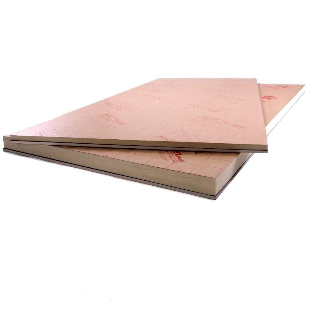

Absoutely this, made huge change in my house by insulating all of upstairs with 50mm PIR added internally. Could chuck some insulated plasterboard in this space with just 12mm of PIR in you can't lose a lot of space and this will likely help massively reduce or eliminate the issue.

PIR backed plasterboard like this
I mean something like tile backer board but it's insulation and instead of tiling you plaster it (so no plasterboard).
