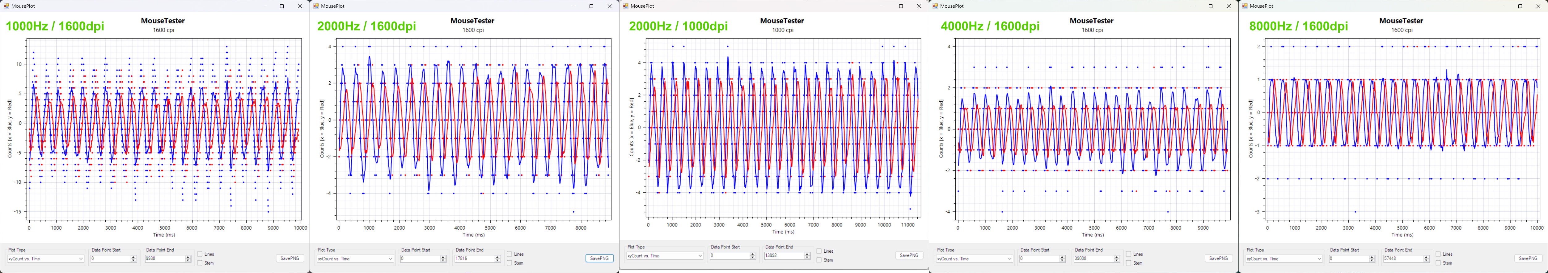

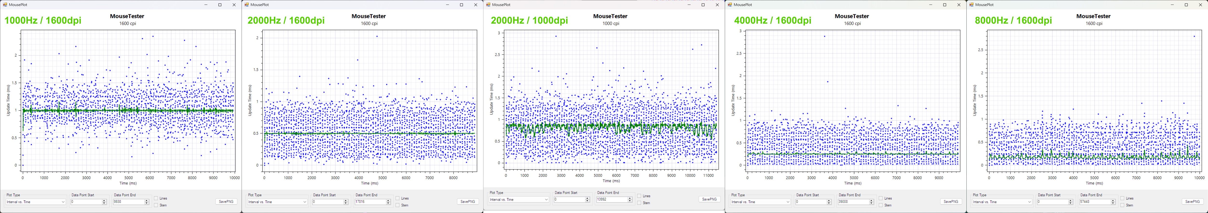

Came across this today and did some testing on my Pulsar F01 with various polling rates and a quick comparison of 1000dpi vs 1600dpi as the right combo of both can make or break optimum performance.
github.com
Essentially the forus is on 3 plotted graphs, the Counts for x/y, Interval and velocity for x/y, what they mean:
Counts:
Velocity:
Interval (Updates):
This is what my F01 resulted with:
I think what this told me was that 4000Hz is the best balance of latency and tracking consistency. 8K has more jitter and the obvious downside to battery life, meanwhile 1k and 2k are smooth but often have a wider spread of data points.
Counts:
The more consistent the pattern that the dots follow, the more accurate the sensor is.
Velocity:
This shows how well the sensor copes with rapid motion and the more consistent the pattern is, the more accurate it is.
Interval (Updates):
This graph displays the latency between the mouse being polled and the system receiving an input; lower and more consistent times are better.
