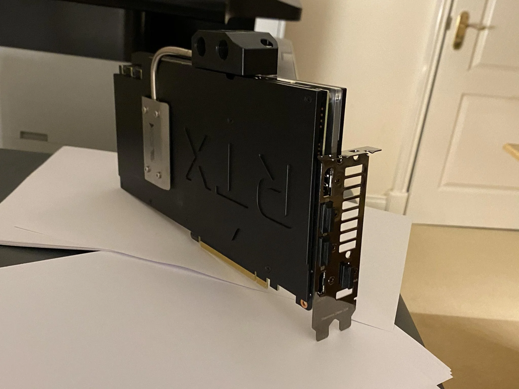

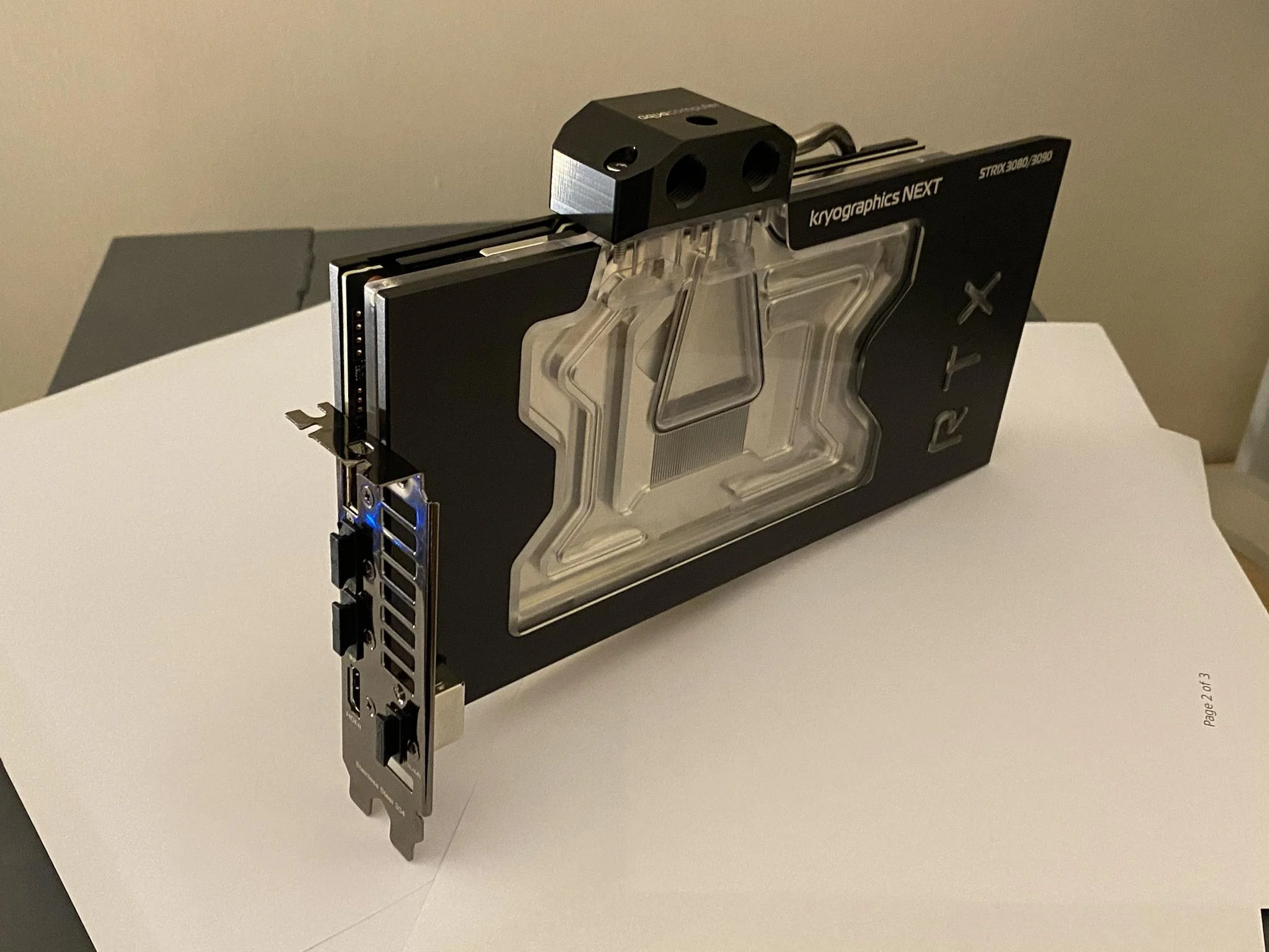

I’ve installed the Aqua computer water block and it performs worse than the EK even with its active back plate.
was a nightmare to install and produces louder coil whine than my Strix did.
Results are under same conditions
GPU temp - 46c
Memory temp - 78C!!
Flow - 4.89 (an improvement there)
not going to bother trying it with the MP5works. No point. The flow will be the same, but the temps most likely won’t be better than the EK.
im going back to the EK water block and applying the revised thermal pad placement and will test without VRM pads to see how that works as without thermal pads on the back of the VRMs there’s no coil whine.
one thing to note though. I have the first revision parallel MP5 works that has no fins. You most likely have the revised version, so apart from the serial version bleeding faster there may not be a difference in temps.
it does look good though

I’ve gone back to the EK water block.
the difference in temps between the thermal pads on the back plate VRMs and with out is 1C all be it at a short stress test, but the coil whine is gone and I’ll monitor it.
My reasoning behind removing them is based on the quality of the stock back plates. They are not going to be doing much to help the VRM so I’m sure it will be fine. The top of the VRM is still thermal padded and water cooled too
