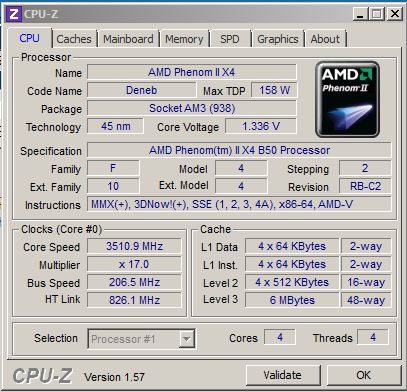

ive unlocked my 550be and it was running ok but i had dodgy ram (put up with it for about a year) and only just got round to getting some new ram (thanks ocuk) and its now working perfectly so trying to do the overclock i wanted to do ages ago
ive got the cpu multiplier x17 and the ht link is at x10 (2000 in the bios) but it shows up as 826 in cpu-z :confused: is this just a wrong value in cpu-z or am i doing something wrong
many thanks for any help, just want to get this sorted out used to get bsod with my old value ram and had to run it under speed so this corsair xms3 stuff from ocuk is working a treat
when i run it at standard 2 cores it shows 2000 for the ht link
but if i unlock 3 or 4 cores then the ht link will go to 800
does the mean unlock failed?

tried it on manual settings and still get 800 ( with no multiplier when cpu is x17 its 820 odd)

yes reports ht link as 2000 as a dual core, have been scouring the internet for info and havent seen anything about a failed unlock prompting the ht link to be under, bsod / no post yes.... (have tried 3rd core disabled and also 4th core disabled same ht link 800 reported)

sooo... i updated the bios and it seems to have done the trick ffs
was using a fairly recent one but oh well can stop scratching my head now
