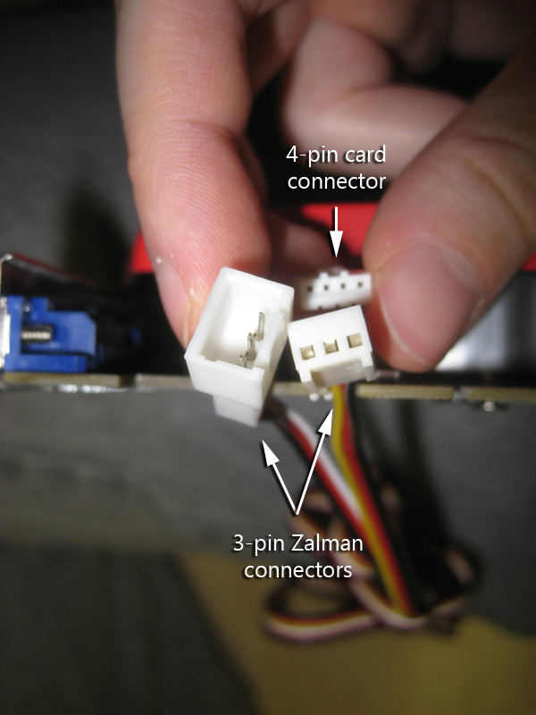

I have an MSI 430GT that is incredibly loud and I'd like to reduce the noise of it. I've tried using Afterburner, but that didn't do anything. I'm guessing that the card doesn't have a way to modify the fan speed via software, but please let me know if this is wrong. Is there a way to control the fan speed via software?
I bought a Zalman Fan Mate 2 fan speed controller, which I was hoping would take care of my problems, but it has three pins and the card's fan connector has four, meaning that it's useless to me. If I can't modify the fan speed via software, what can I use instead of this controller?

jellybeard, I don't think the connector is full size, as even if I broke the side off the Zalman connector, the pins don't line up properly and wouldn't sit inside the connector housing on the card.
PwnDirect, It's an OC version. I don't know what temperature it's running at as nothing I use seems to give me that information including Afterburner and RivaTuner.
Tealc, a 4-pin to 3 pin converter is exactly what I'd love but I can't find one. Can you link me to one please? And no, only three of the pins are populated.
I've taken some photos to show you what I've got.

The 4 pin connector is the XHP-4 type which for PWM control via your graphics driver needs the blue wire in the fourth hole. It could be that your card doesn't have a PWM output and cannot therefore control it's own fan. It could be that the manufacturer simply didn't want you slowing the fan down. Looking at the images it seems the PCB doesn't even have a PWM pin.
Be very careful of temperatures if you do slow the fan down as it may overheat. Anything under 90 degrees under load is fine.
