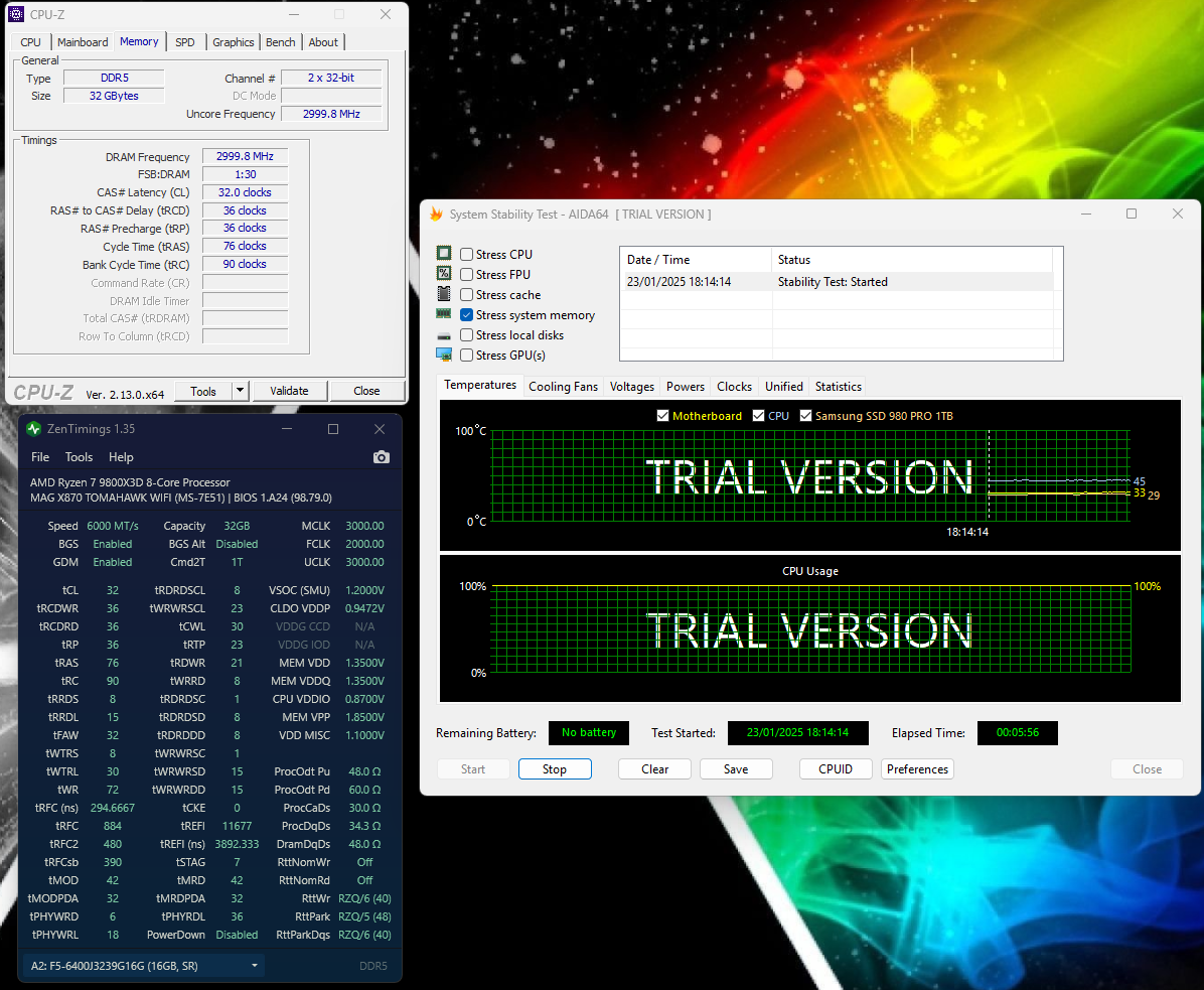

Will run AIDA64 system memory stress test for an hour and see how we go.
Yea Aida64 and Cinebench are usually the go to benchmarks, TestMem5 is also good for reliability testing
Here's my timings
Ran fine for hours, but Aida64 latency was 81ms which seems ridiculously high to me
