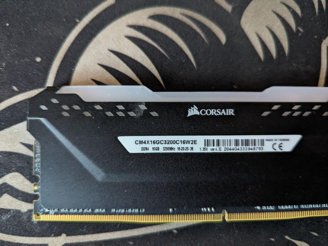

also any specific ram i need? this is the Ram it came with.
Corsair change their memory chips even on the same model, so unless you get exactly the same revision it is just luck (if it'll work happily together) either way I'm afraid.
