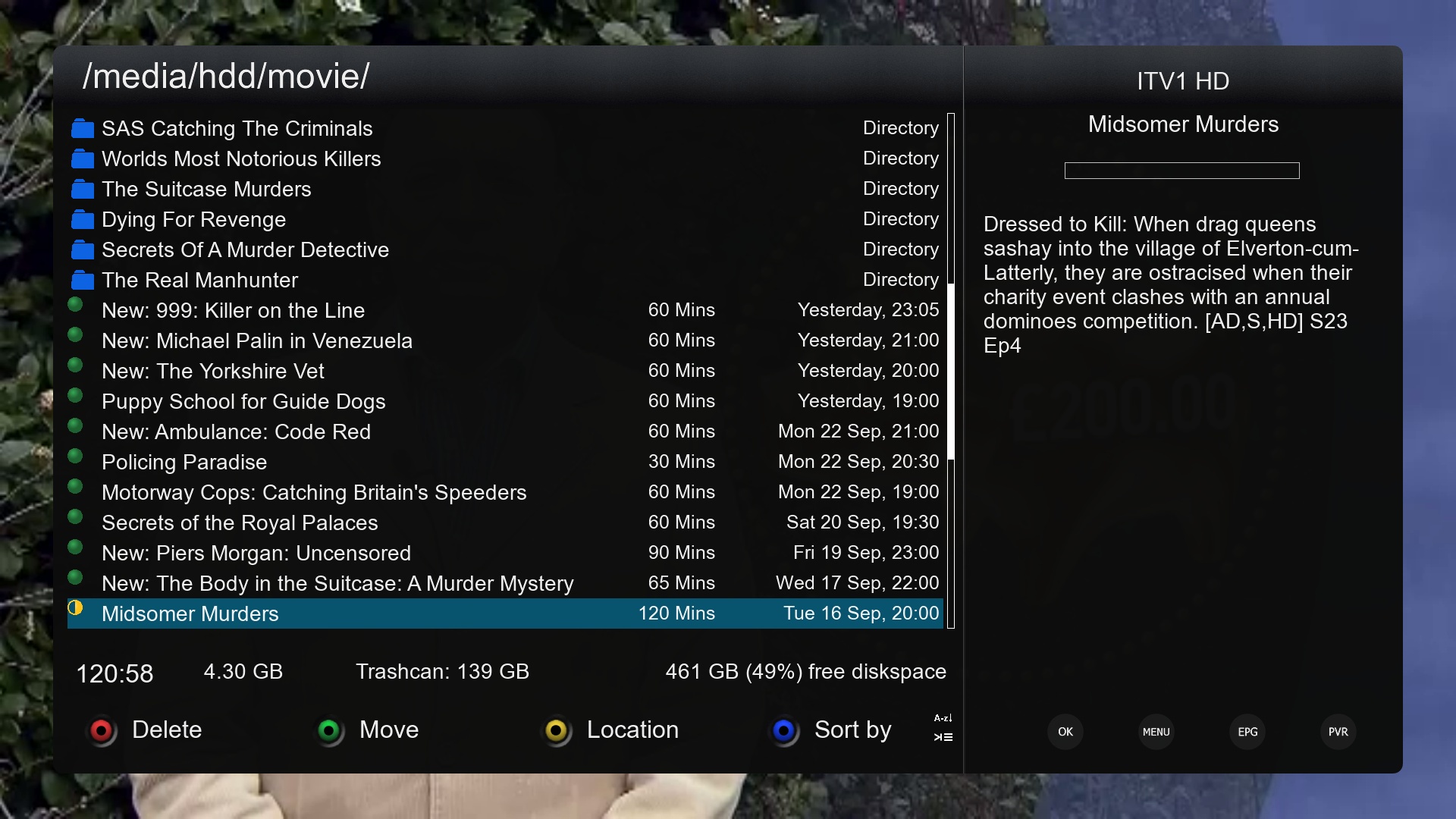

For many years I have used a VU+ Uno4K unicable satellite receiver that can record up to 8 channels at once.
My wife is the main user and uses 3 other rooms in the house for different things, so in each room I've bought a Firestick, put KODI on it and an Enigma 2 plugin and she can access the VU+ from all the rooms.
It works brilliantly.

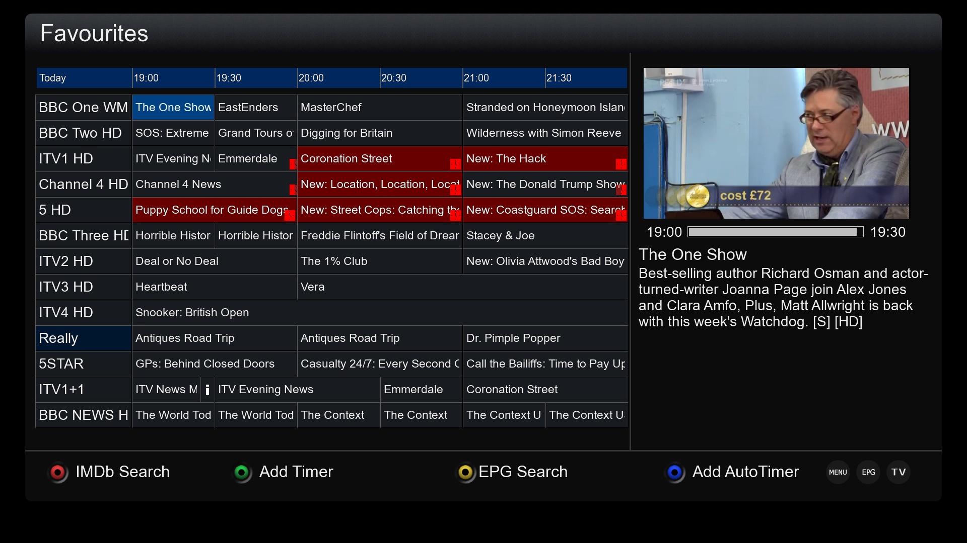

My wife is 66 and has no problems programming it, it's just a normal EPG.
She then has no problems with KODI playing from the receiver.
