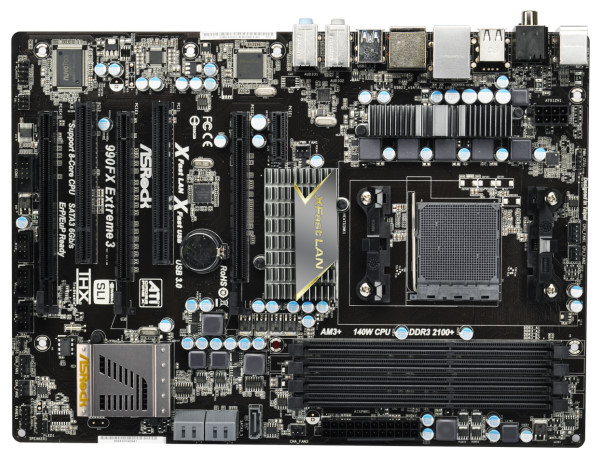

So I decided to give my computer an upgrade, I put a new asrock 990fx extreme 3 in it, a new 8 core amd 3.5ghz processor and new nzxt 530 case, worked great first couple of days. Last night I was watching a film and all of a sudden both monitors go black as if the computer has turned off even tho all leds are still on, fans still running nothing changed as far as I can tell, the computer also wouldn't turn off by holding the power button. I've checked the power to the monitors there all fine I checked the dvi cables all ok, as far as I can see there's no hardware problems at all, but today I turned it on for an hour and then the same problem happens but I left it just on black screen and what's happening is its rebooting itself I have no idea what to do, I can't reset the cmos because the mobo has no battery on it as far as I can see..
If you need any more info please ask and ill tell you what ever I can
Lets start with a full spec including brand / output of the power supply.
Also, your motherboard does have a battery - it's close to the GPU socket
What CPU are you running? If its the 8320 (or 8350) you may need a BIOS update..
The CMOS is below the PCI-E slot (top one).
