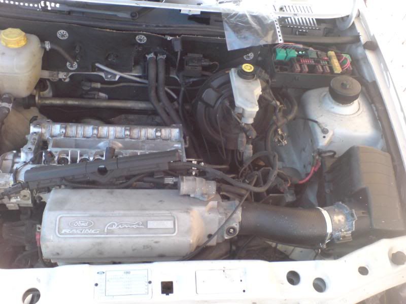

By request heres a bit on my uncomplete fiesta
Started with this
This went in
This came out
Got this done
Old pic with the frp inlet on and no cams, however its all back together apart from a cambelt atm.
Using these wheels which will be wearing toyo proxes r888's
Not pictured
FK Silverline coilovers
280mm Fiesta ST front brakes (as to fit under 15's)
280mm Focus RS rear brakes
powder coated Zetec-S Ream beam (stronger)
blueflame catback exhaust
thats all I can think of at the moment.

well frp spec is 155bhp and ill have a ported/polished head.. it will need a custom remap so its anyones guess really. Wonder how much weight ill save with the interior taken out and spare wheel removed, should have thought to weight it all really lol.

Im not going to give any performance estimates as ive still not decided which gearbox to go with yet (1.25 short ratio/1.7 longer ratio) or whether im gonna spend money putting a quaife diff in to put the power down better on launches/in corners.

I was running it with just the puma engine and nothing else uprated including brakes, standard pea shooter exhaust 14" wheels.. basically exactly as it is in the first pic. Now the first thing I had a traffic light GP with was a Mk5 Fiesta Zetec-S.. you know the type.. polished to high heaven zsoc stickers and a big exhaust. oh how the victory was sweet, the driver must have thought something was wrong with his car for it to get whipped by a 1.25 LX lmao.
