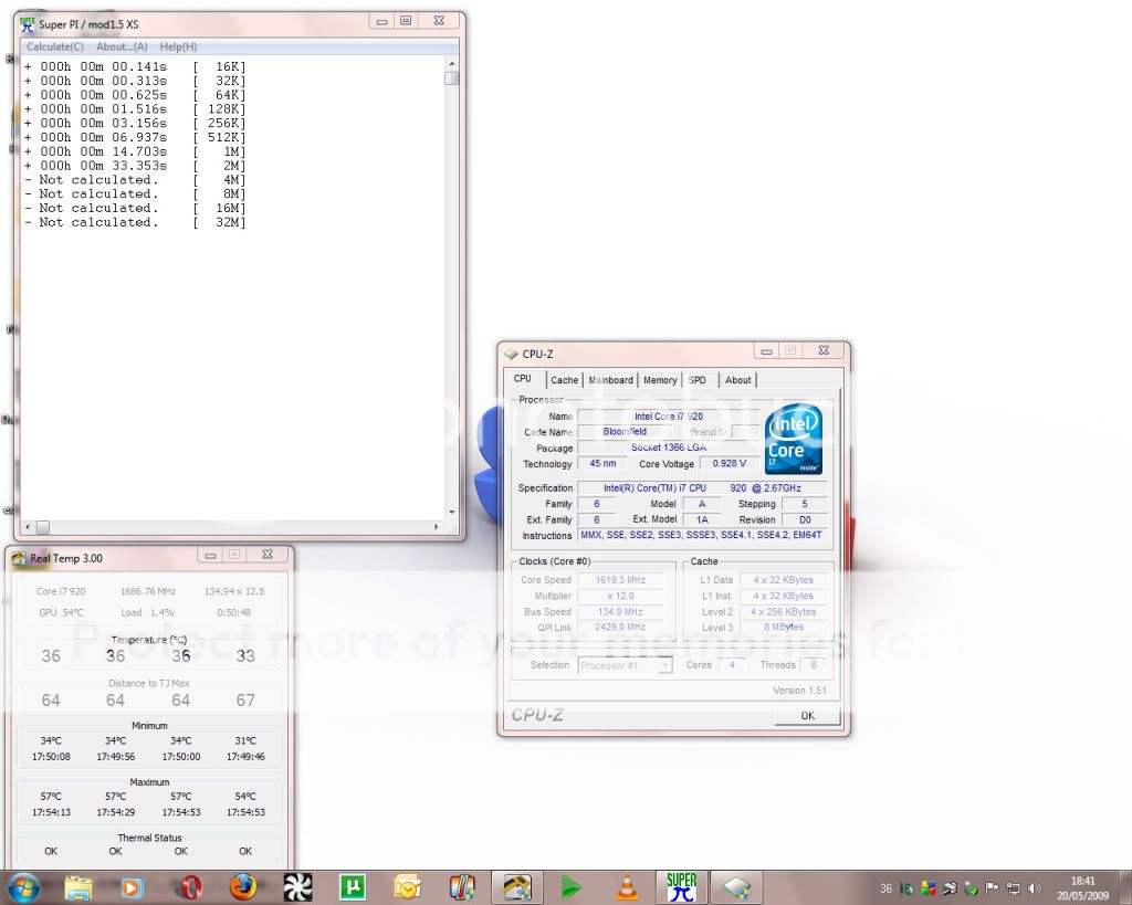

Hiya Folks
I'm not a total Noob.;)
But the i920 is a very new area to me([email protected] was the last one)
I have read a little amount regarding clocking the i920 and the UD5. but not much goes in until you actually start.
So as a start I have just increased the bclk to 190 and left everything else at stock or auto.
here is my pre overclock
And here is my post quick overclock after a 30 min run of prime95(blend)
The temps are a little too high for me they didnt go above 89Deg until I put the sides back on my case.
Everything is set to Auto.
So thats my next job is getting the Volts down to bring the temp down.
Thats where I'm a little stuck there seems to be a whole host of adjustments.
So not sure whether to try decreasing the volts or increasing the bclk to see what the max is???
Matt
