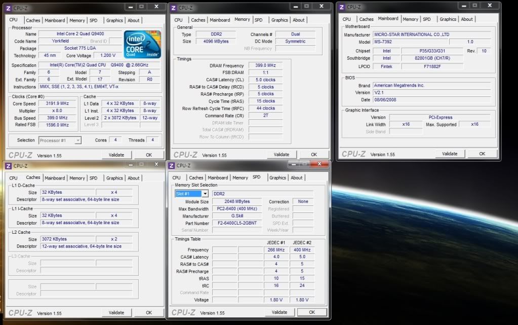

My overclock look ok?

As above really this is my first overclock ive ever done seems ok its stable but just want some confirmation please :)
Looks very reasonable.
Now stress test it with Prime for at least 8 hours, that will tell you if its stable, then you might want to run your most commonly used app for a few hours and see if its stale with that.
You shouldn't have a problem with that CPU @ 3.2 even with the voltages at auto, I had mine to 3.8 and primed over 13 hours stable but knocked it back to 3.4 as I didn't need the extra.

I'm no expert but it could be your mobo holding you back, I'm not sure how good the p31's are for overclocking, hopefully someone with more knowledge can help more.
If it's your first overclock you should be proud of your achievement :)
The screenies look fine
Just run a stress test for the suggested time to prove stability and it's a goer!!!
Well done matey :)
PS. Now you've got the bug I wonder how long before the need for a further tweak is deemed necessary?....lol
yes and only about an hour, was just checking to see if all that looked OK
