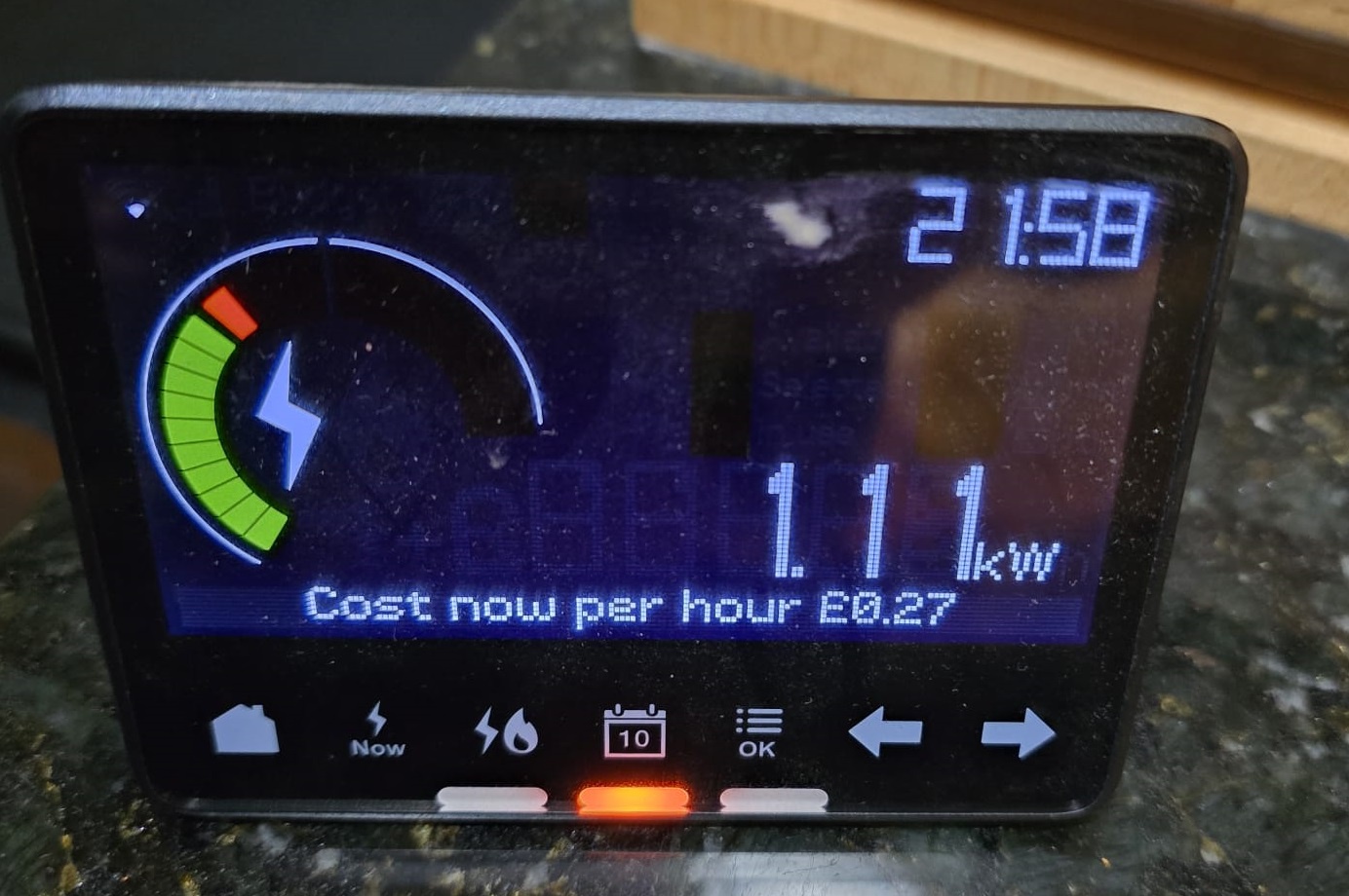

Since this was flagged up to me as abnormal, I've been paying close attention to the data. According to the Octopus Home Display thing, in the last few weeks I've had several >£20 days, with a couple of >£30 days. This is getting really pricey and I want to figure out if there's anything I can do to fix this, since even solar panels wont help me generate 100kW a day unless I install a solar farm in the garden I think.
My display shows a consistent baseline of around 1.2kW usage at all times. That's currently costing around 30p/hr. Last night I did some investigation, here's the baseline usage:
This is with most of the family asleep, a couple of devices like a laptop on charge, and a few lights on in the house (all LEDs). All other devices like desktop PCs, TVs etc were on standby. No dishwasher/washing machine/tumble dryer (condenser type) in use.

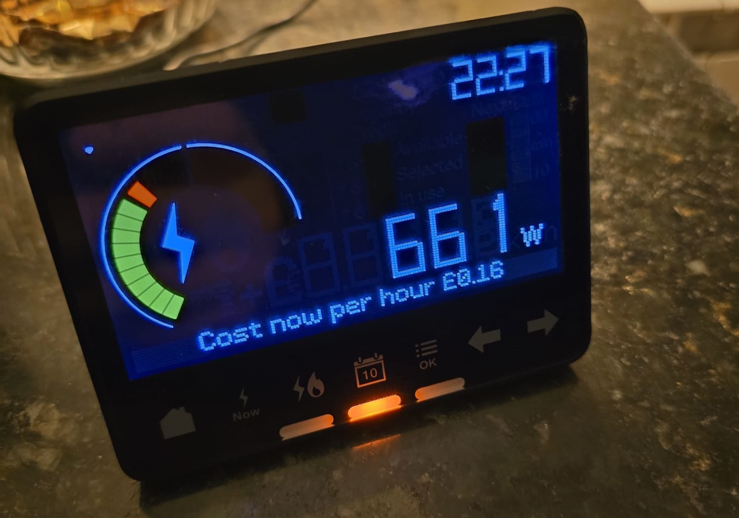

So I went to my circuit board things, and flipped every single switch down one at a time looking for culprits:
  • I went to the basement first, turned off all the circuit breakers for the water circulation pumps, boiler, pressure pumps etc. Hardly any difference.
  • Turned off the power to the car charger (not in use), no difference.
  • Turned off power to outside lights and floodlights, no difference.
  • Turned off rooms and parts of the house via the circuit board one at a time. Not many rooms made much difference, turning off the kitchen with the fridges and freezers etc dropped things by a bit.
By the time every single circuit board switch in the property was off, and the house was effectively in total darkness, this was what the display showed:
So that's left me scratching my head. Why am I still using 0.66kW of power at that time? £0.16/hr doesn't seem like that big of a deal since it's just under £4/day, but when a 'good' day is a £12 spend and a bad day is £20+, I'd quite like to get that £4 down. Secondly, the general baseline usage of the house as above with things on standby and no big appliances in use is around 0.5kW (~£0.09/hr) which seems ok to me?

If you mean my circuit breaker box things then as in my post, I'm left with ~660W being used with all switches down.

What I did was have everything on as in the original pic so 1.11kW.
Then turn off the breaker for a single small room, dropped to around 1.09kW or something, so a negligible drop. Then I put the small room breaker back on, put the smart meter display in that room, and then turned off every other breaker for every other room/area/supply in the property one at a time and monitored the display. End result was that 661W pic.
Can you turn off absolutey every breaker apart from the room you isolated at 20w? I.e. the small room?
That's what I did, apologies if I wasn't explaining it clearly.
Small 20W room breaker up.
Every other room breaker (kitchens, bedrooms, living rooms, etc) down.
All swimming pool circuit breakers down (were already all down anyway, includes garage, shed, outdoor lighting etc).
All basement circuit breakers (boilers/pumps/zappi car charger/water tanks etc) down.
The end result of doing exactly that is the 661W pic.

Loads of replies - thank you - but unless I'm missing something I've done a fairly exhaustive test of all the circuit breakers in the property turned off resulting in that 661W figure.
