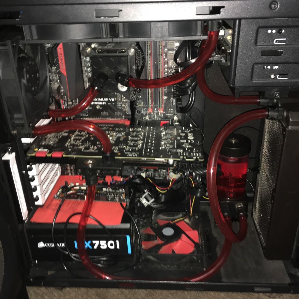

I've recently done one mate you could have searched.
240 up top 240 in front and a 120 at the rear. Temps have yet to go over 45oc on the GPU. Will hopefully be a bit better once I get the Aquaero all set up and finished.
