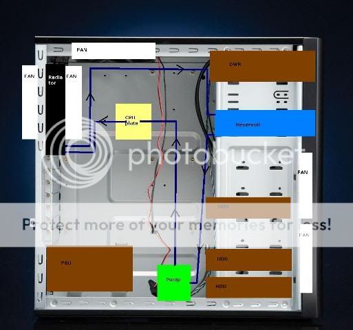

I just have quick sketch with Paint – this is how I was planning to make loop, If I make mistake, or you think is are better place for the pump or another component – please, let me know.

Pumps can be summarised as laing = good, if too expensive then look for high head pressure. Bay reservoirs look too likely to leak for me to want to use one, so I know nothing about them. Perhaps they're fine, but I'd never trust one.
A 60mm thick radiator probably wont fit there with a fan, but measure your motherboard and case to be sure. Is there anywhere else you can put the hard drives? Two in the optical bays, one on the floor of the case perhaps. The radiator might fit better at the top, measure this place too.

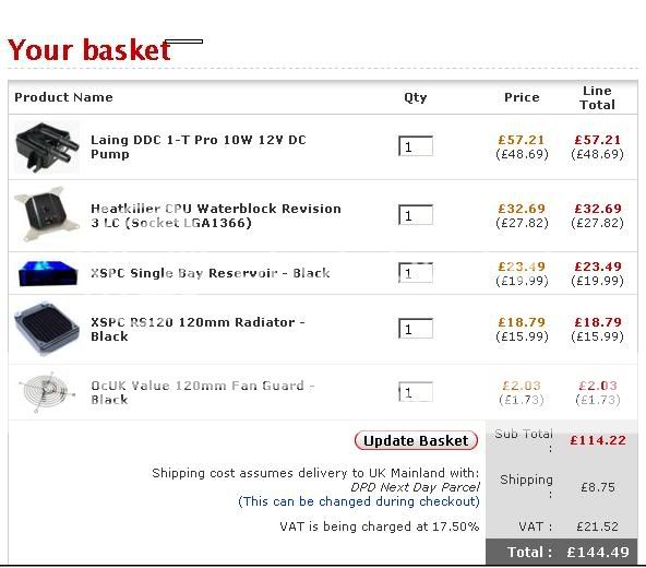

Ok below is a spec that will fit in the antec 300 using the rear fan mount, did'nt add fan/fans in as thats personal choice.
As said before the thicker rads simply won't work in that rear position, i would'nt class this spec as performance, but it is better then the H50.
this is only a guide.
This XSPC RS120 120mm Radiator - Black should be no problem to fit in my case is only 121x35x155mm. I believe is decent is well. But is out of stock…. JonJ678 recommending Laing made pump – how about this; Laing DDC 1-T Pro 10W 12V DC Pump ? XSPC Single Bay Reservoir – Black is out of stock and aquatuning have only silver version, that sad, because case is black…. CPU blocks, are Heatkiller CPU Waterblock Revision 3 LC is not better then EK Supreme LT ? Do I need to look for back plates for them is well ?

The heatkiller lt and ek supreme lt are about the same, I think I'd choose the heatkiller but either is good. A backplate isn't required but is a good thing to have, as it lets you put more pressure on the cpu without damaging the motherboard.
The thing I'd change there is the reservoir to this one.
I know you like the idea of a bay reservoir, but this one will take up less space and perform significantly better. It also lets you use any barbs you like with the pump, instead of the plastic ones. The 10W ddc is ideal if it fits within budget, exactly the right pump to get.
Can you fit a second radiator in the top of the case? I still think the way to go is a 240 in the front with the hard drives mounted to the radiator using something like these.
These fix three hard drives to a 120mm fan, so you can hang them off the radiator. Those particular brackets are from mountainmods, the photo is just to illustrate the idea.

Nope. A 240 would be better, clearly. This is why I'm trying to lead the OP towards the a 240 mounted where the hard drive cage is. However the H50 is an example of a thin 120mm radiator with distinctly budget pump and cpu block, and it still matches air.
There's not a chance the H50 will outperform the above. If he can use a 60mm thick radiator I'd be confident in it trouncing the H50, but the OP doesn't think it'll fit, and looking at photos of the 300 I suspect he's correct. Just a shame it has to be inside an antec 300.
