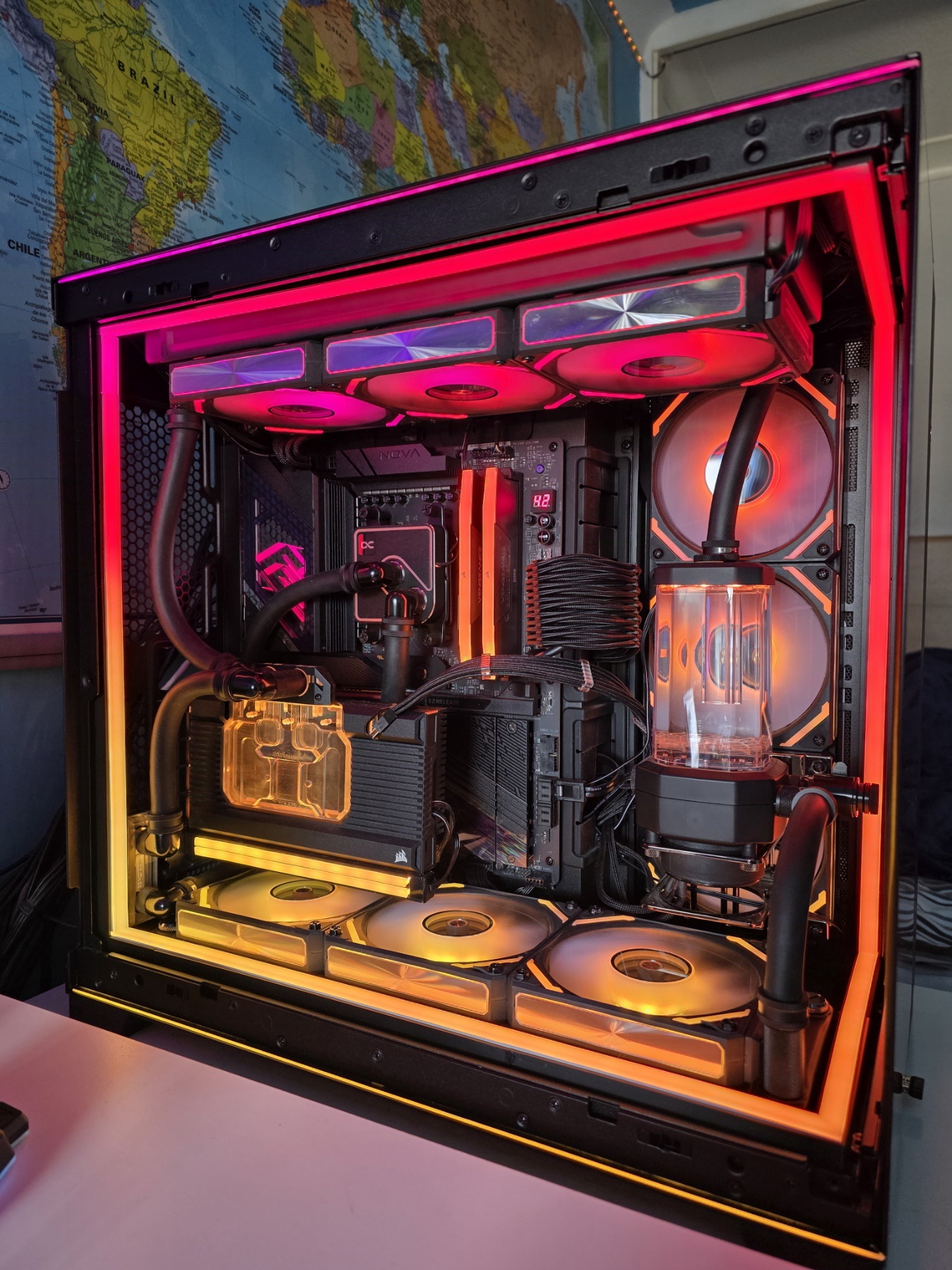

I'm using Signal RGB, and i'm using the BeQuiet 900DX case, all of the fans are connected to the strip in the case as is the AIO and it's syncing together. The issue I have is in Signal RGB all 7 fans and the AIO are coming up as a single item and it's not detecting different channels that fans are connected to.
I also have it where the case is not syncing up correctly.
Part of the lights are a different colour and i'm not sure why.
Picture of what i mean as the below link, sorry not letting me insert it as a picture for some reason.

I havn't daisy chained, i've connected each fan on it's own to the hub, i've then connected the hub to the Mobo the problem i have is signal RGB doesn't detect the individual fans and as far as i'm aware the case is connected correctly it's just one portion of the strip itself doesn't sync and the rest does.

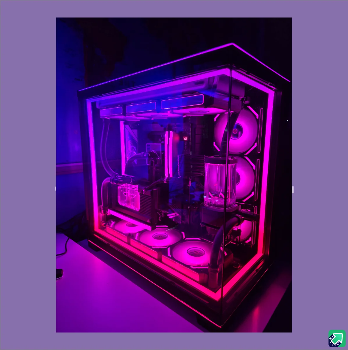

Guessing you put some sort of diffuser on those?
I've put a link to the Manufacturer website. Surely it's "OC Legal"
It's a silica neon diffuser.
