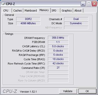

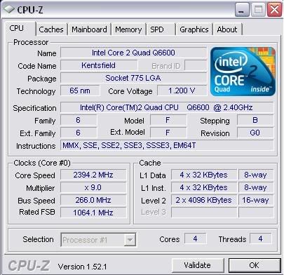

On a quick note however i downloaded cpuz-z Results below !
Cheers for any help.
Righty-ho... so we've established that its not an OS issue so its probably hardware or config related.

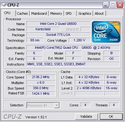

First thing I can see from the screenshots is that something is pretty badly awry. Your CPU is set at 2.1Ghz, when at stock it should be 2.4Ghz and clocked should be 3.3Ghz!
What type of RAM do you have, as that FSB looks strange, unless its 1066 DDR2.

It says that my cpu is running at 3.2 on everything else which suprised me when running this CPU-Z program !

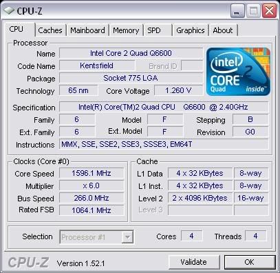

It seems to show the left pic for a second and then the right pic seems to be what its sitting at now !

That's just speedstep knocking the clock speed down.
Ah yes, I'd forgotten about Speedstep, never use it. Will - all speedstep does is underclock the CPU in order to save power, hence CPU-Z reporting the bouncing up and down of speeds.

odd how corevoltage is lower at x6 multi than x9?
speedstep could be under that name, also disable C1E and i like to set cpu ratio to x9 manually

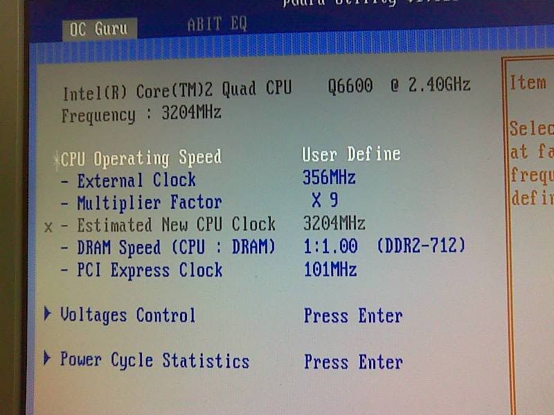

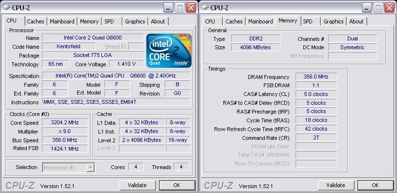

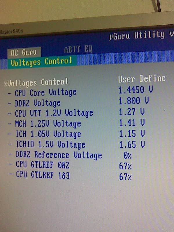

So i've applied the OC settings in the bios and also done the couple of things that people said on here.
This is how it looks now.
I haven't gotten to playing the game but will be giving it a go shortly...
