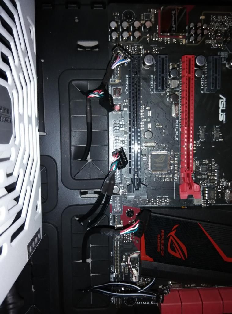

Are you only using mounting standoffs where there is a hole on the board?
i.e shorting out the board.
I have the phantom 820 case, all 9 standoffs are in correct places for the motherboard, the screws all go in without a hitch, i check the space between motherboard and back plate, nothing it touching the motherboard except for the standoffs.

The next course of action i've taken is to order a super flower 1000w leadex, so once thats arrives i'll wire it all back up and give it another bash, the phantom 820 case seems to be a quality case, its grounded and the backplate to the heatsink isnt touching anything and the motherboard is only touching the 9 standoff points.

Sorry for the huge images, but just to show the 9 stand offs, then screwed in and the back plate is clear.
