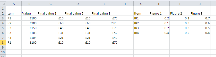

Here's how I would do it - Start by creating a reference table to determine what your percentages are. I've done it on the same sheet below (the table on the right), but you could use a hidden sheet for this part.
Then, on the table on the left, I've used a simple vlookup to get the result I need for each price.

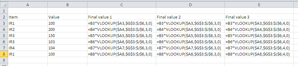

If we take C3 as an example, I'll explain whats happening. First, ignore the "$" signs. These just tell excel that the following character should not automatically be changed if I duplicate the cell somewhere else.
So, ignoring them, A3 looks like this:
=B3*vlookup(A3,G3:J6,3,0)
=The amount you need to divide up
Tells the forumla what to search for (IR1, IR2, IR3 etc
This is the area of the spreadsheet it searches in. This should be the entire area of your "reference table"
This is the number of the colomn you want to return a result for. *Note* - This is relative to the "range" you set, not the actual cell number. If my range is G-J, then column G is "1", column H is "2" and so on
This tells the vlookup to only show a result on an exact match. If you set it to 1, it uses a non-exact method)
You can see the way it works is by multiplying the initial value by the amount in the reference table, so your figure should be 0.XX where XX is the the percentage of the initial value you want to show. So if you want 20%, set it to 0.20, if you want 30%, its 0.30 etc etc
