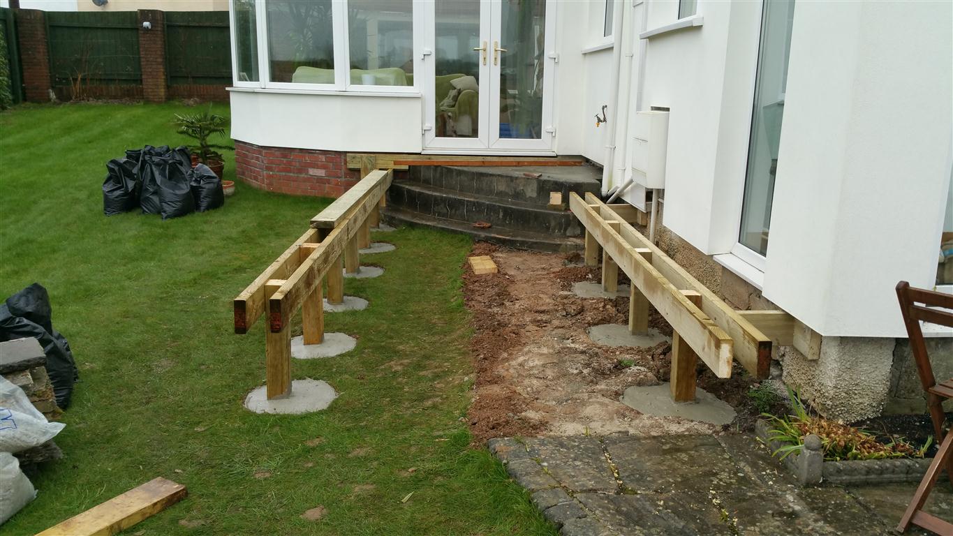

I can add a little here. I've completed a similar sized deck. Approximately 3.3m x 5m. I used 200mm end joists and 175mm main joists. However mine do span 3.3m without a central post.
For your deck, I would do 150mm at least for the joists as the span for half of them will be the full 3m. There are tables available to tell you how long a joist can be between supports on a normal floor. Even though my deck has 175mm joists, there is still some give in the centre of the deck. I am now completing another deck, this time higher and 2.7m wide supported on beams. See the last photos, this deck has less give and was much easier to construct!

How flat is the ground you are putting it on? If it's nice and flat then you could just post the end joists for security and where you have the internal posts, do away with them and dig holes and put in a small concrete square/block, lay the joists on top of them with some damp proof course between the wood and concrete.

If I understand correctly, you're suggesting making a concrete base to sit the decking on? This would allow me to use smaller joists, but I'm guessing it'll cost a fair amount to construct the base.

eniacs; thanks for the input. I'm surprised to hear that you get flex in yours. Perhaps I should stick with the original plan of 150mm. I'm thinking worse case scenario, having 10 adults stood on it at a time - that's a lot of weight!

Mushtafa - I did have flex, you could tell the deck was suspended above the floor, ie not solid. But its not flex that I would worry about, the joists are within their design spec. I would prefer not to have flex so would next time go the extra for a method that didnt. Personal preference to be honest, you may not be as OCD as me!

No. Just where you propose to have posts sunk into the ground you dig a small hole, such as 300x300mm wide and about 600mm deep. Fill with concrete (or postcrete if you don't mind the expense) and make a small box to sit above the hole and give you the ability to bring the concrete out of the ground slightly. Put a small piece of DPC on top of the concrete and lay the joists across that.
If you have spare bits of rock/brick/rubble etc you can throw some of that in to save using so much postcrete too :)
