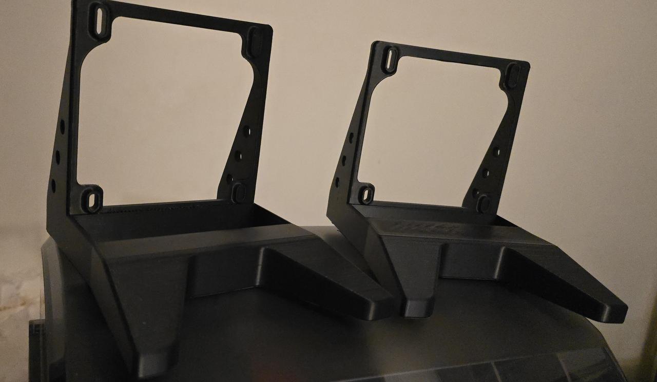

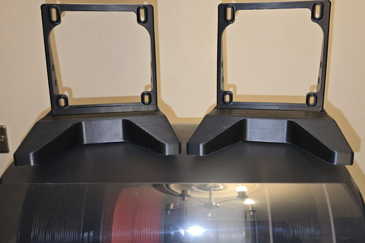

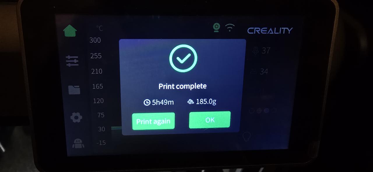

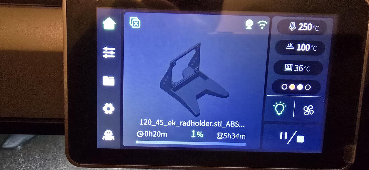

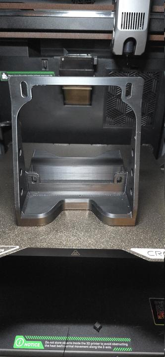

Came out really well in ABS Pro at 0.2mm layers on the standard 0.4mm nozzle. I upped the infill from the 15% it was configured with to 18% just to give it a little more strength without using much extra material.
All of the supports auto added came away really well too, sometimes they embed themselves almost too well but on this, they were a cinch to remove.

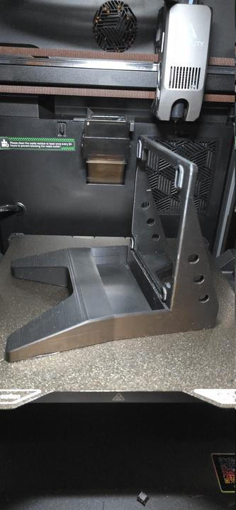

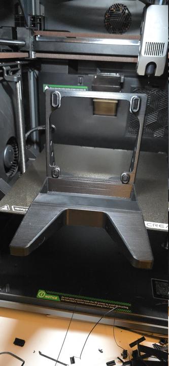

Second one finished, printed it at 45 degrees perpendicular to the first one and it came out even better as the supports practically fell off this one.
