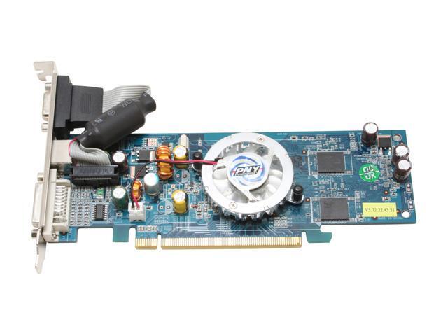

I was told this card was silent, but its not... grrr
Im looking for a silent cooler to fit it, but im wary of getting a zalman, as I dont think it'll fit as the gpu is too low on the board, any ideas??
You cmight be able to fit one of the Zalman passive heatsinks used for chipsets on there. It looks about the right size.
Obviously you'd want to make sure there's some airflow in that area with a passive cooler.
The Zalman VF700 & VF900 are offset to allow for this. The VF700 fits at an angle and I'd be surprised if it doesn't fit. OTOH the Zalmans are probably overkill for that card, judging by the original, and I found a Startech cooler that works well on my X1300 card. Unfortunately I can't tell you more as it came from a competitor.
Well i pulled a passive heatsink of an old AGP GF4 I had, I hacked a few bits of it, where the caps where but it fits ok.
I just did a round of 3dmark05 and it reached 93'C - This to me seems right toasty, but the threshold says 130'C, and I didnt crash or get any corruptions.
I have now ordered a VF700 anyway, so hopefully it'll fit. (this thing was meant to be cheap... its getting more expensive by the min... )
Having just looked again, its idling at 88'C :eek:

No idea. I changed because the standard one was too noisy. The Startech is permanently on 5V and doesn't get very warm at all and certainly very little noise. But I'm not gaming on it; it was in my test PC and mainly used to run Virtual PC.
