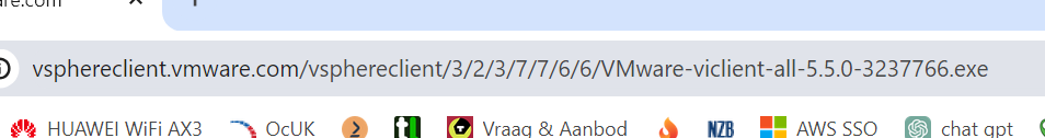

Url on the web-ui of Esxi (server from 2013/14) points to a dead url.
Does anyone know where you can download vSpehre client 5.5 for windows?
I really need to reconfigure some old VM's.
Somehow all the links I can find on the net are dead. So annoying as I can't manage the VM's properly now. This is a version of Esxi before you could do anything via the web-ui.
You should be able to get it from here:

Nope, official site says not allowed even if I create an account.
2nd website I already found myself, but all download links are dead.

I can download it from the website no problem, so must be an issue your end.
Yeah, thankfully you don't work anywhere I do :) Use esxcli if you don't have the software. Imagine if we didn't have progress for software/hardware. But hey, glad you managed to get it resolved.
Hmmm, that is odd, I've tried multiple browsers, internet connections (home, office, mobile) and for me none of them work.
Managed to do what I wanted via the CLI in the end by opening SSH on Esxi...
