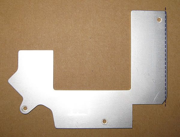

Remove the aluminium plate from the cooler (retained by three screws), trim end (see dashed lines) and refit. Trim just enough to clear offending components and NO more.
Image not to scale
