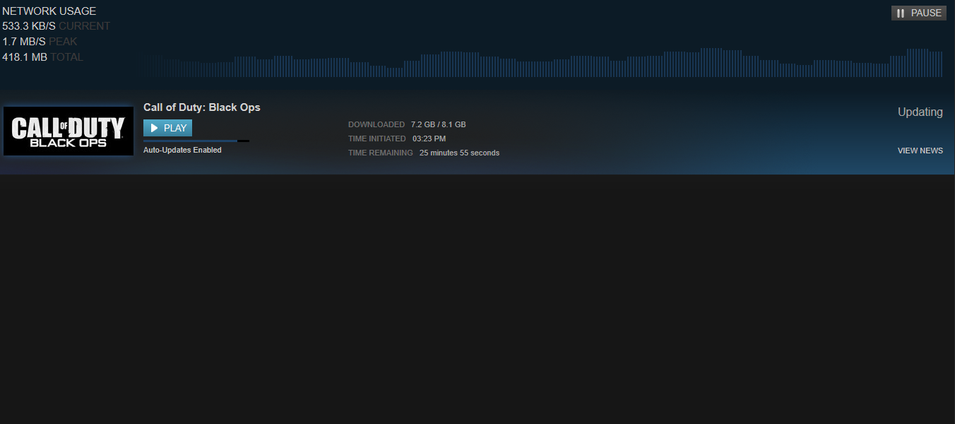

This one is from my PC (which is is in my bedroom, wireless connection). Shows how the download speeds fluctuate:
