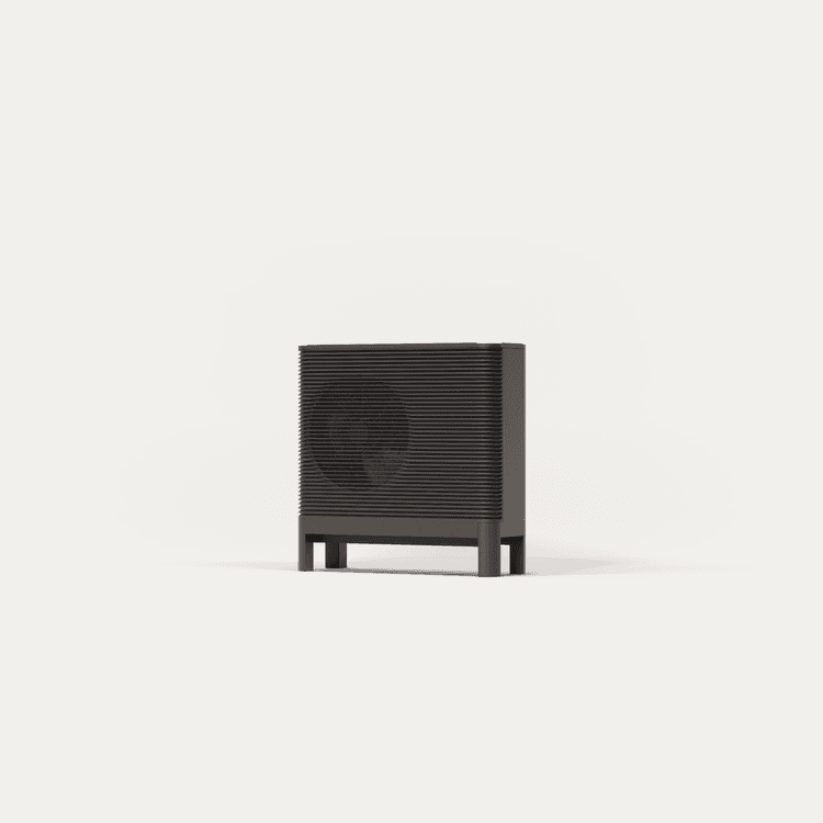

Aira are bringing their own ASHP to the market, think he said the 6kW and 8kW are out now but the bigger ones are due Sep. They have a 15yr warranty, and a SCOP of 4.7 @35ºC which isn't as groundbreaking as their sales guy tried to convey. They do only make 57dB though, and the warranty is good. He did say they're based on the Arotherm.

Anyone good a quote from Aira?
Had guy round today (sales guy, not the full heat loss guy). Decided to proceed to get a heat loss survey from them. Have found the following concerns for discussion with their technical guy next time:
- buffer intrinsic part of design. Needs properly set up and controlled which is hard to avoid efficiency losses through distortion. Seems to only exist in the arrangement with a separate loop for the rads interfacing with this buffer tank. They're going to guarantee it's warm enough, but will it be cheap (electric efficient) enough?
- limited performance data on the heat pump on the data sheet, no COP for hot water cycle.
- a lot of the functionality seems to be tied to the app, if they go bust or abandon the app and/or servers, will the machine fall over and be uncontrollable?
Things to think about, will post back if I learn anything.
Quote is best of the lot so far for 6kW unit and 7 rads and replacing a bunch of microbore.
Aira aren’t a new company are they, just new into the U.K. market?
My daikin has a buffer but it’s plumed to increase volume, not create hydronic separation. The latter is where you get the efficiency drop via the water mixing in the buffer. The former is to make sure there is enough water in the system for the defrost cycle.
I managed to dig out a flowsheet on their website and it definitely implies it's piped up as a buffer not just a volumiser. Both flows and returns connected unless two just pass in and out of the enclosure without being plumbed in.
I asked their tech guy when they were round for a full heat loss last week.
He said it was to add volume not hydronic separation.
I was originally quoted for a 12kW but he said we might get down to an 8 as the house is well insulated, wet UFH etc
Also mentioned the Aira units are based on the Vailliant. Made in Poland.
