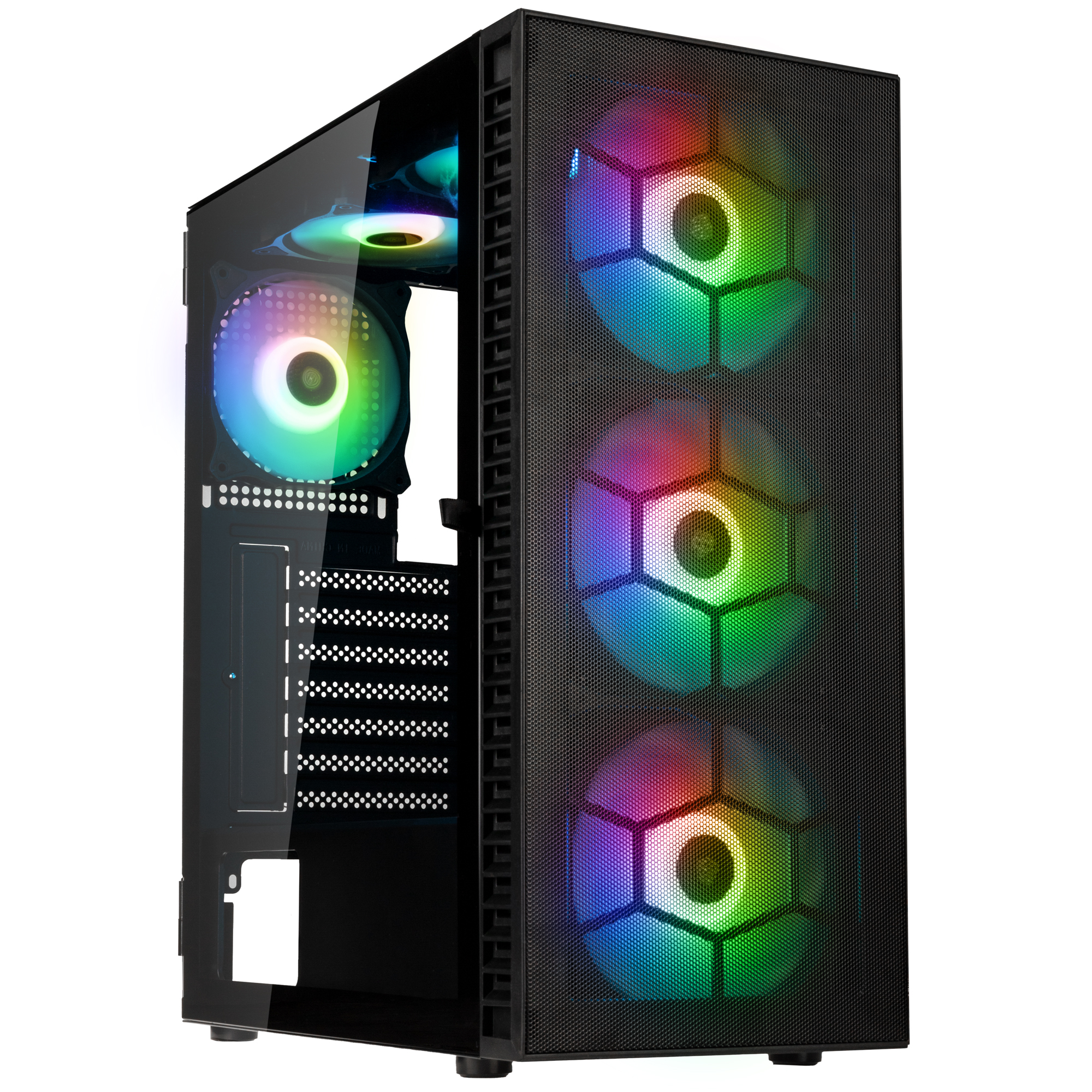

Case is that ok for you ?

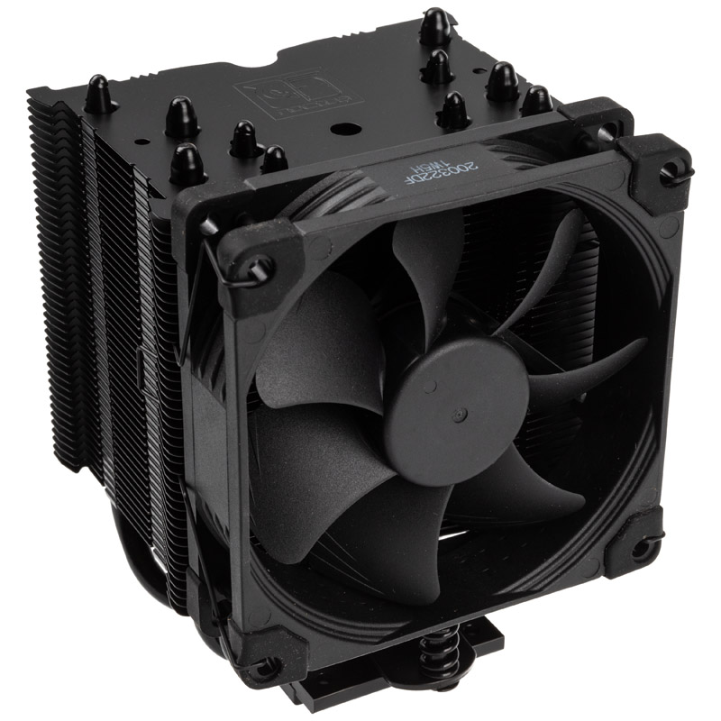

CPU cooler £32 optional.

If you can stretch your budget a little there's some slight improvements to make like adding a better cooler and improve PSU.

Case is good thanks, and I think I can stretch for the extra's.

Does anyone know if the CPU cooler comes with thermal paste already applied or comes with a tube of paste that I need to apply myself?
