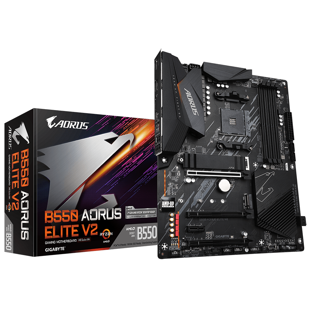

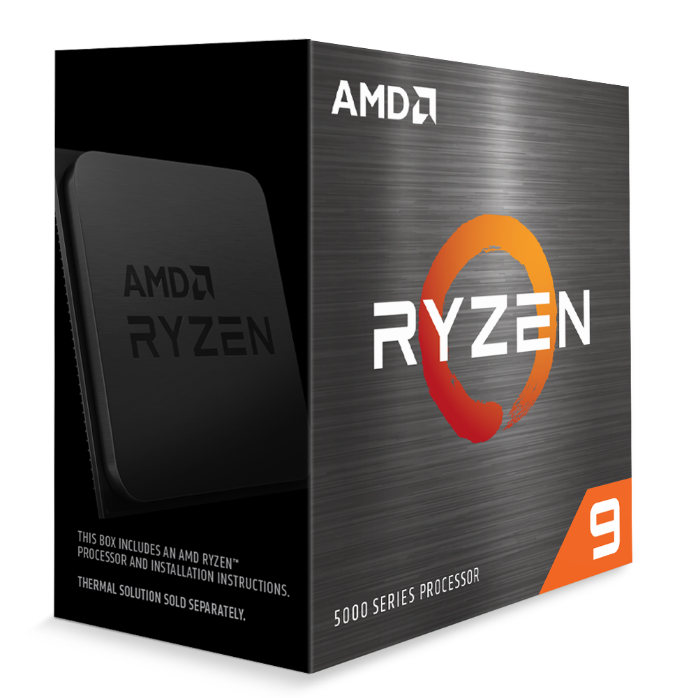

This plus an RtX A4500. You’ll drop a little performance from a 7950X but the A4500 is really fast for CUDA.
Honestly unless you need the extra vram there's no real reason for a rtx a series in most 3D software, you might as well just grab the geforce version and save some cash or go one step higher, in this case a 4080. An on offer a4500 is just under £1,100, it's usually £1,600, the 4080 can be had for around £1,100-1,200... 4GB less vram but far faster cuda performance.
Also I'd argue that you might as well go AM5 7900/7900x as it's about the same multi-threaded performance as the 5950x (I have a 5950x) but opens up the am5 platform for future upgrades etc and gives you better single core performance. Having said that, I'm not sure I could recommend an AMD system with all the current issues.....if I was buying this very minute I think I'd be picking intel.
