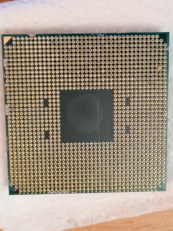

So the RAM turned up and i ge thte same problem so took the cpu out and took some pic, not bent pins but the are a couple of pins that look a bit out of place, thre pins look like the are connected together, top right ahnd corner, ten pins from the top and two pins from the right ahand side inwards.
https://i.postimg.cc/sxPKt0rm/IMG-20220216-135503.jpg
I don't know if this corretct or not.

That isn't right.
Return the CPU to the vendor, or setup and RMA with AMD. AMD will collect the part and replace it for you.
Yes i just looked here, and can see those pins are not meant to be like that.

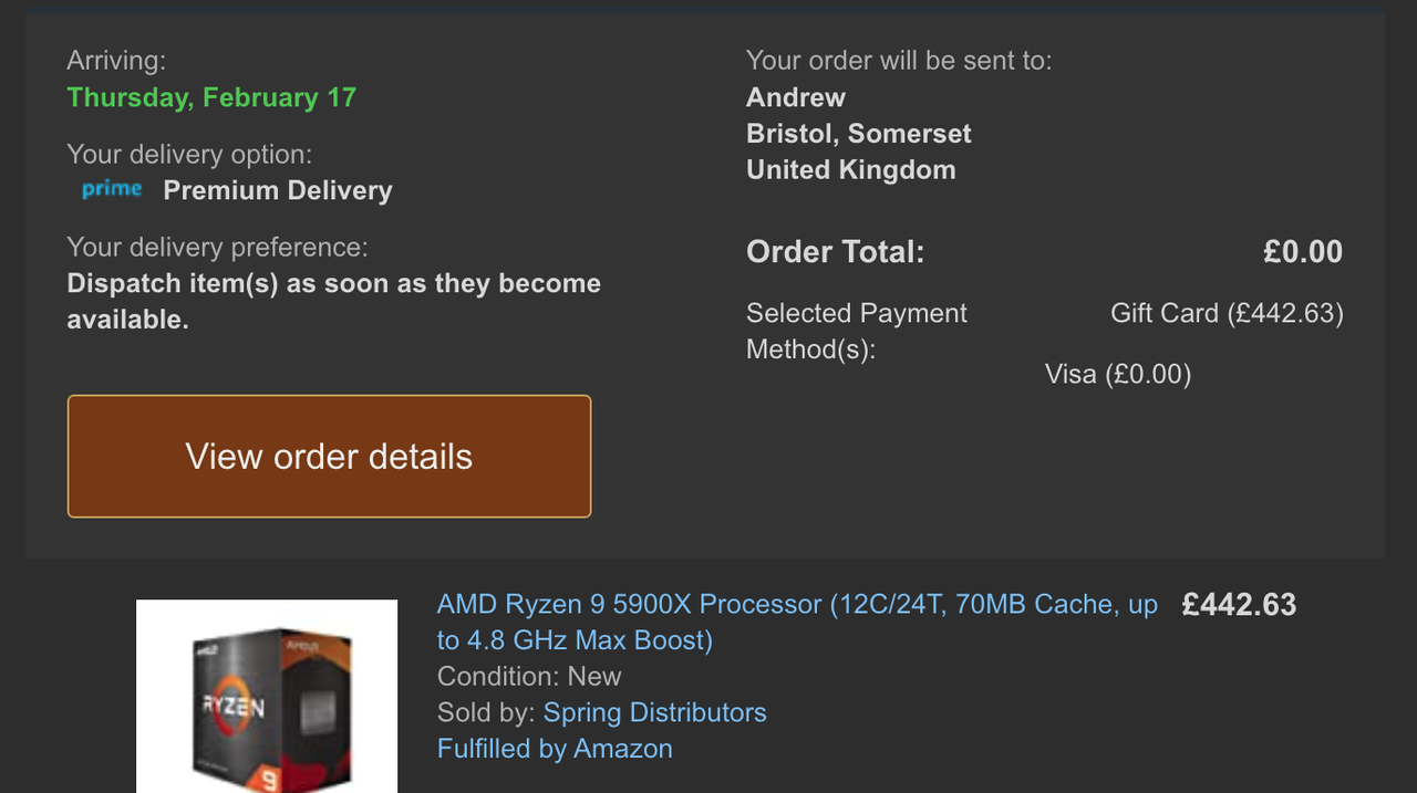

Man i do not like Amazon one little bit but i have to say i am impressed buy their service.
Should be with me tomorrow.

The one in the photo you uploaded looked very 'not-right' (as in it looked like several pins were shorted with paste or similar, plus one not centered on the pad)

I filled a return request this afternoon and dropped it into royal mail at about 18.45pm and an hour later amazon gave me a refund and I bought another strait away.
The paste was from me taking the cpu off the first time but it did exactly the same on the second and third fit, there was paste on the edge but not on the bottom of the pins but as you can see the problem was most likely the fused pins. I found a couple of pics of other fused pins and they said it is manufacturing fault/quality control issue, either way the new one should be here tomorrow so will let you know how it goes.
