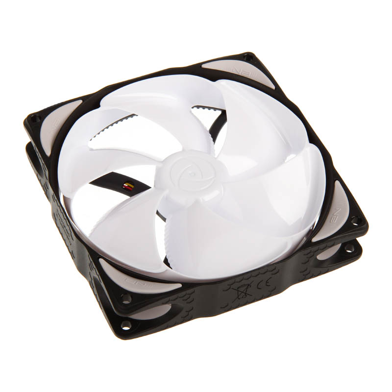

Cases look nice, but that seems to be all they has going for themselves .. and low price, add another £30-40 for 2 or 3 good fans and there are better cases that come with good fans at similar price

Also keep in mind it take 1.5x 120mm fans to move about the same amount of air as 1x 140mm fan does. So 2x 120mm intakes only leaves 1/2 of one fan's airflow to supply all the air the 2x or 3x 90mm fans on your GPU use .. end result is both CPU and GPU coolers will be re-using their own heated exhaust air trying to cool .. and every degree warmer the air going into cooler is translates to a degree hotter CPU and/or GPU will be. ;)

At the very least move the back exhaust to front as 2nd front intake. This will almost double case airflow.
Better yet, replace them with 2 or 3 120mm fans with pressure rating of 1.72mm H2O or higher at 1600rpm like PH-F120MP so when you slow them down to about 1000rpm they still have high enough pressure rating (>1.0mm H2O) to overcome grill and filter.
