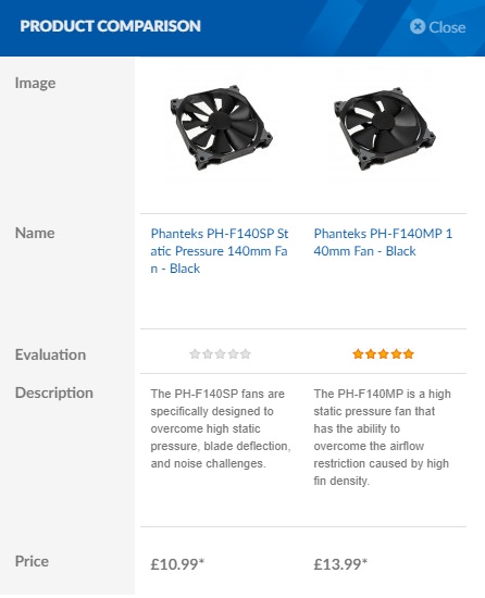

and what about top fans ? would i need some or not ? and thanks very much for this
MP ones are out of stock tho :/
I assume the stock case fans have impellers like PH-F140MP, at least they used to be. Assuming they are then the 3 of them in the front are all the fans you need. Control them so they cycle in sync with our GPU and cooler fans so case fans are moving a little more air into case than CPU and GPU are using. That way their heated air is moving on back and out of case.
