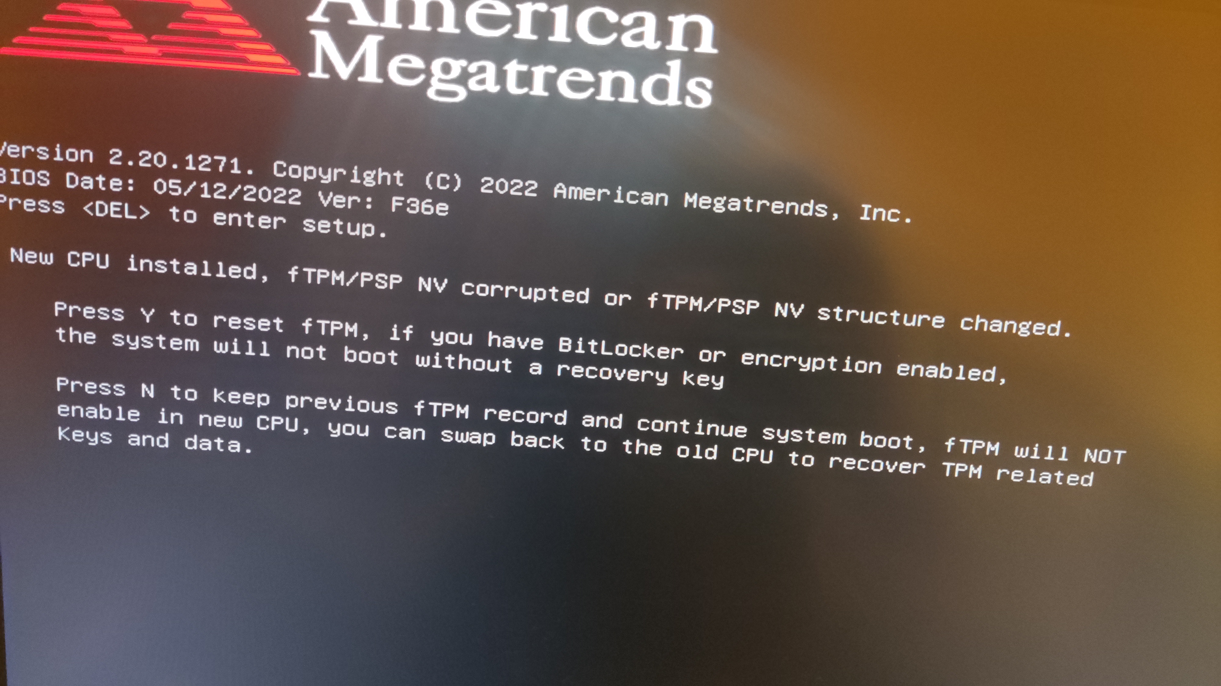

A local account is not tied to your Microsoft account, it is completely separate and uses an unrelated password. If you have never signed in to any Microsoft service through Windows, then you should have a local account.
If you sign in with a pin or other form of ID, it is possible that you're using Windows Hello and this feature is tied to the TPM.
If you change CPU, or update the BIOS, it can clear (or prompt you to clear) the TPM keys and this can break Windows Hello (and if enabled, Bitlocker).
If you have never cleared the keys, installing the old CPU can restore access to the OS and allow you to recover it, but you can't turn off TPM-linked features once enabled unless you can gain access.
The reason I'm asking these questions is because if you're only having password problems, it suggests perhaps you forgot, or are using the wrong password, but if you're having TPM-related problems, then installing the old CPU is probably the most likely fix (assuming you have no other means of recovery and have not yet cleared the keys).
Phone pic.
Earlier on, I entered the BIOS and re-enabled TPM, though it still lead me to the same problem.
From what I can see there, it would be best to choose no or shut down and install the old CPU, which will hopefully allow you to recover the OS.
After you have done that, you can then choose the best way to deal with this problem prior to installing the new CPU.
Did this disable/enable process clear the keys? If it did, reinstalling the old CPU may not help you, unfortunately.
If you don't have Bitlocker enabled, you may still be able to recover your files by using the SSD as a secondary drive, but I'm not sure what happens if Hello is enabled and Bitlocker is disabled.
Casting my mind back earlier, I 'think' when I was first presented with this welcome screen (in phone pic), I believe I hit 'Y'. :/
Looks like I have no option but to reinstall Windows.

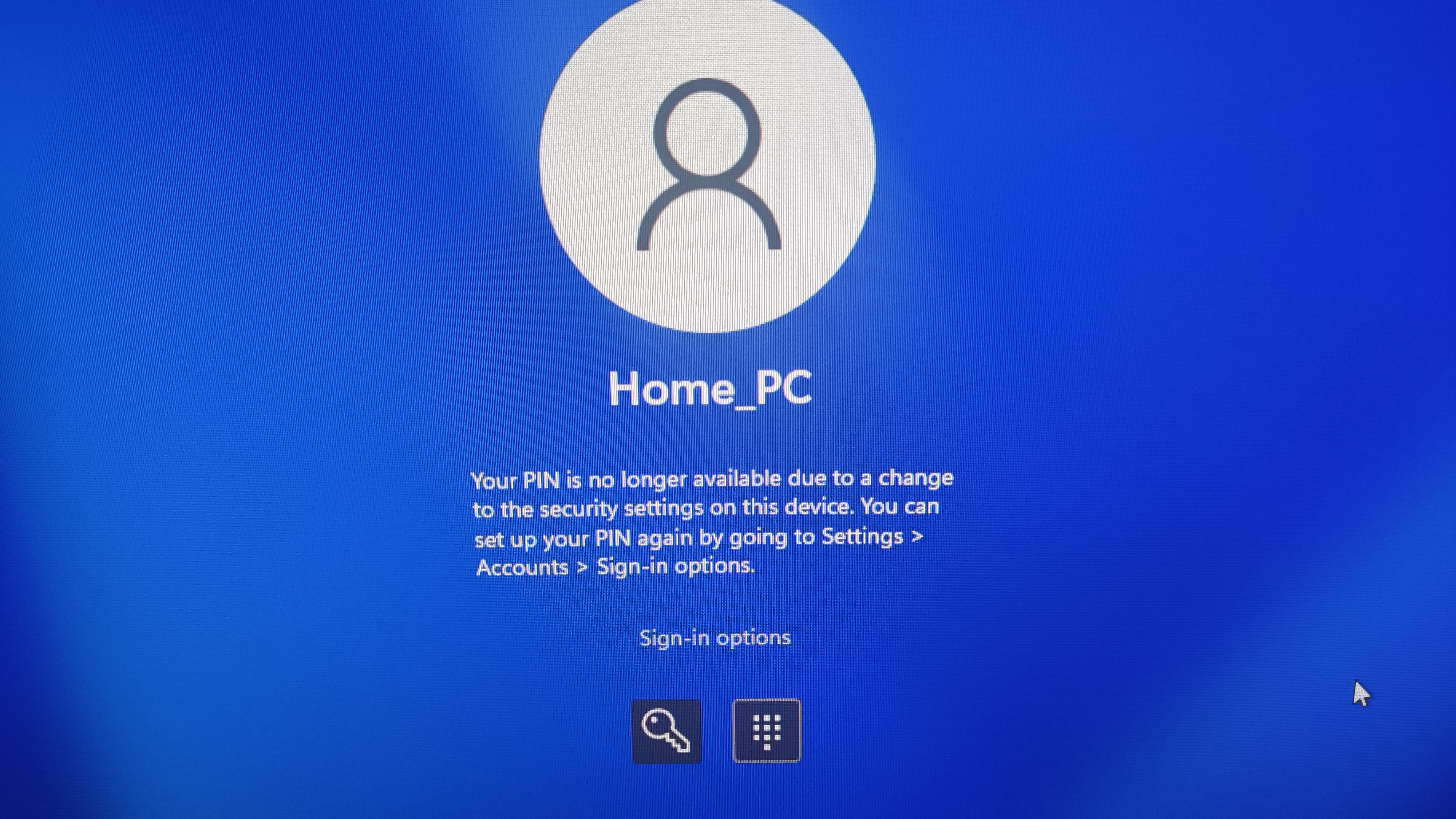

Another phone pic showing the login screen.
Aha, yeah, I believe that's Windows Hello (hence, tied to the TPM).
I assume you chose the option of signing into your Microsoft account? Can you reset or recover the password from that account?
I'm not sure what other reset options exist.
It worked!
I'm in desktop.
Thank you so much! :)
In the words of Blackadder, "I want to kiss your cherry red lips and nibble your shell-like ears!".
Cheers, you're a gentleman.
I had this on my second PC switching from 2200g to a 4300g on my X470 board.. I basically logged in with my password then removed the Pin and readded a new Pin, works like it should now.
Good to see you sorted it out without having to reinstall :)
