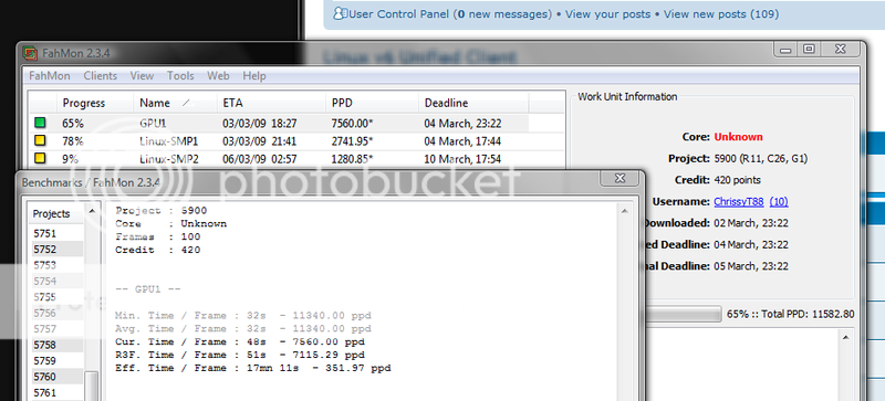

Well, just got back and fired up the old folding box to take some screenies... and my ppd is a little on the low side! The screenshot shows my current FahMon and benchmark scores. Adjusting the priority hasnt really made a shred of difference to points today, unlike yesterday where it made all the difference in the world! I havent put up task manager shots because with the SMP clients running its at 100% all the time, and EVGA precision reads a constant temp of 64C, with lots of fluctuations down to 63.
EDIT: Also visible is a cursed p5102... *shudder*
