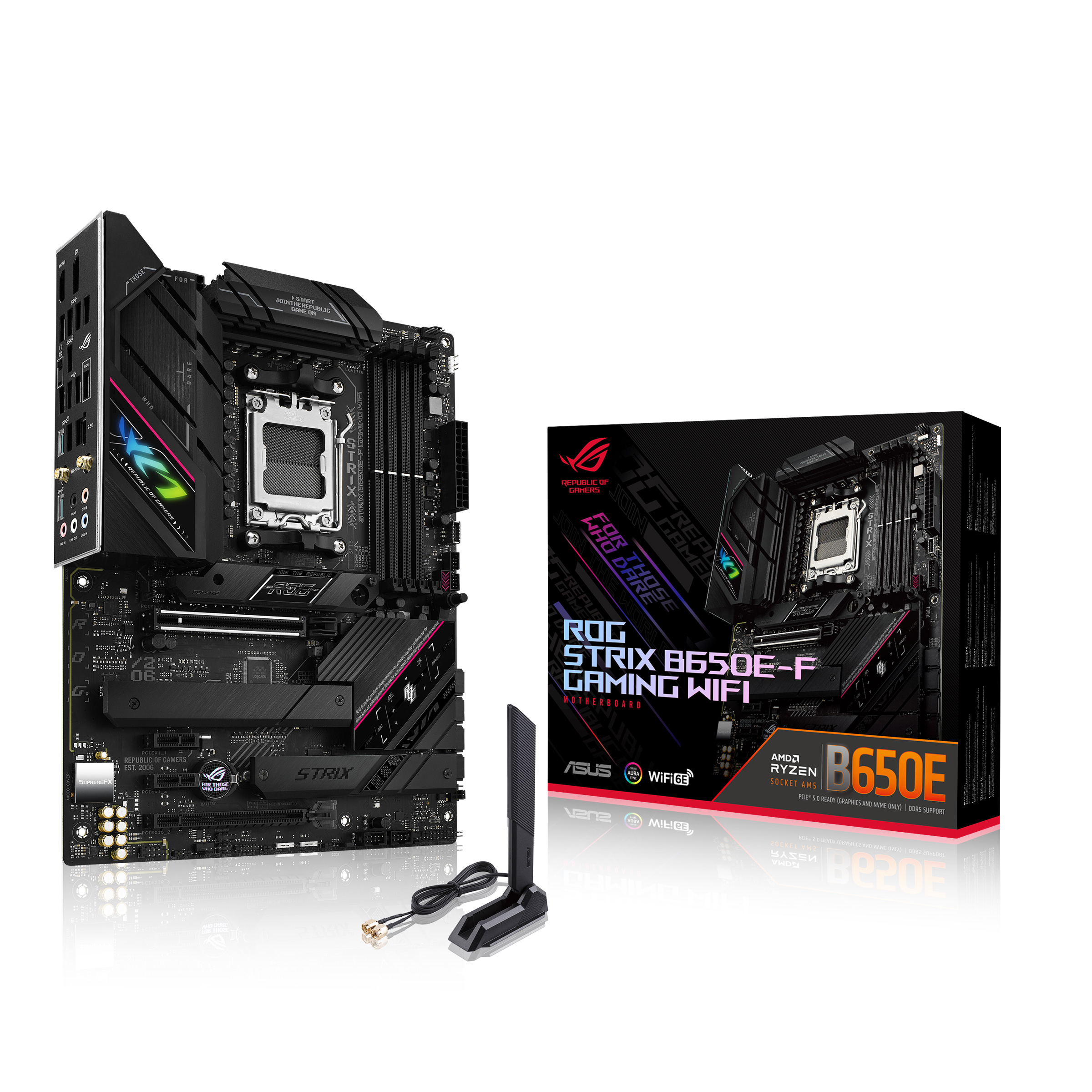

For a system with a 4090, I'd go 1000 or higher, but 850 is likely to be sufficient, especially with an AMD X3D CPU:
My basket at OcUK:
The SHIFT requires a compatible case due to the side placement of the modular panel.
I thought that intel is the best at the moment, no problem for me, it's even better if it's faster thanks for advice, would you recommend a motherboard for this?
At stock they are about even, AMD will win some, Intel will win some. If you OC the intel system especially the ram it'll end up a bit faster overall but not much in it. The main advantage of going with AMD is that AM5 may have another 2 generations of CPUs which will be supported on the current boards while intel will only have one more.

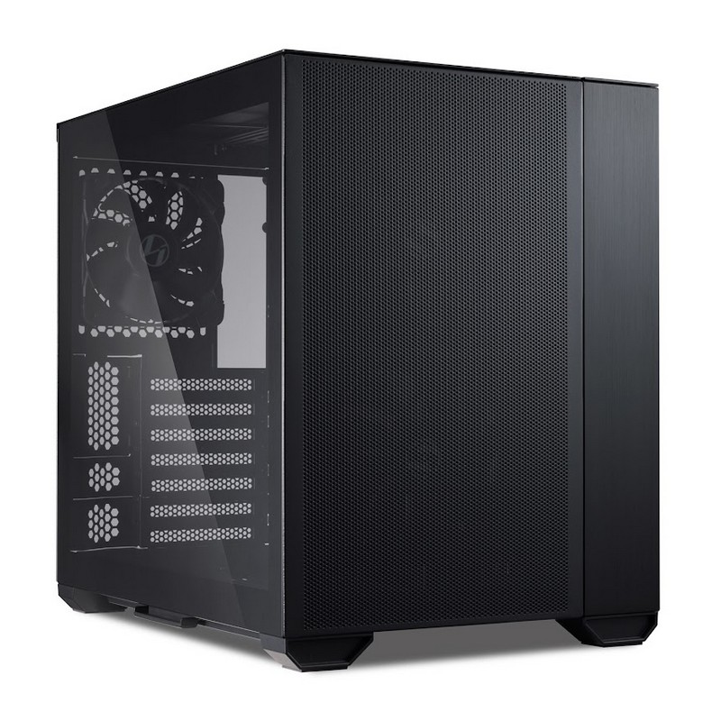

The Zotac Trinity 4090 is 356.1mm and the clearance of that case is 360mm. Bit tight, me thinks. I'd look at the 5000D, or Lian Li's 216.
