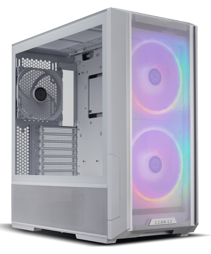

Just some more suggestions regarding case ?
Their have been some really good suggestions already, but would welcome more input.
Zotac cards come with a 5 year warranty if registered within 30 days otherwise it's 3 years so yes highly recommend that.
Case.
Plenty room in in theese.
