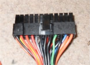

Here is a picture of both the 24 pin connector from the new corsair and the old 20 pin. (apart from the obvious 4 extra pins) I noticed that the 20 pin plug has a white cable 3rd in from the left but the 24 pin doesn't have any cable in that area. Normal I guess?
new 24 pin.
old 20 pin.

On the 24 pin connector, 4 of those pins (left side in pic) will slide off to allow them to fit an older 20 pin socket. Also the 8 pin socket should fit using just one side of the connector (some psu's may supply an adaptor that steps 8 down to 4).

For reference the missing wire is the -5V that was removed from the ATX specs a while back. I can't exactly remember what it was used for but I've got a feeling it may have been involved with the old ISA expansion slots. Whatever the case it's unlikely to be the cause of your problems.
