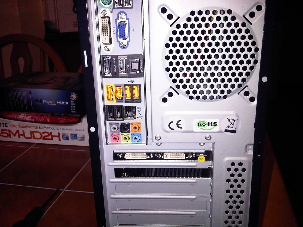

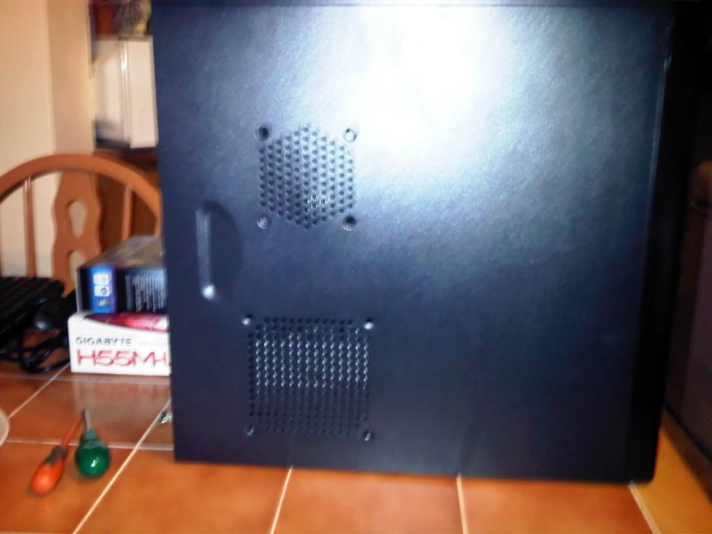

on the subject of more cooling would it be worth installing some case fans to? as at the moment there are none just the fan on the psu, cpu and gpu.
there is a place on the rear and 2 possible side options.

The top side vent seems to be 80mm, I'd put an intake fan there (blowing in), and a 120mm exhaust on the back.
Should lower your temps significantly even on a stock cooler :)

Yea definitely need some air flow and a better PSU. I used those cases and PSU for a couple builds i did for some friends and although there are good for everyday use once you stick a decent graphics card in the they do tend to get a bit warm. The front panel does come of to reveal a place to put a fan, just make sure you it on the outside of the chassis as this will get you better air flow in my experience.
With better airflow and PSU you could do a bit of overclocking on the stock cooler but not much . you would want to look into something like this http://www.overclockers.co.uk/showproduct.php?prodid=HS-010-NC if you want to do some real overclocking.
