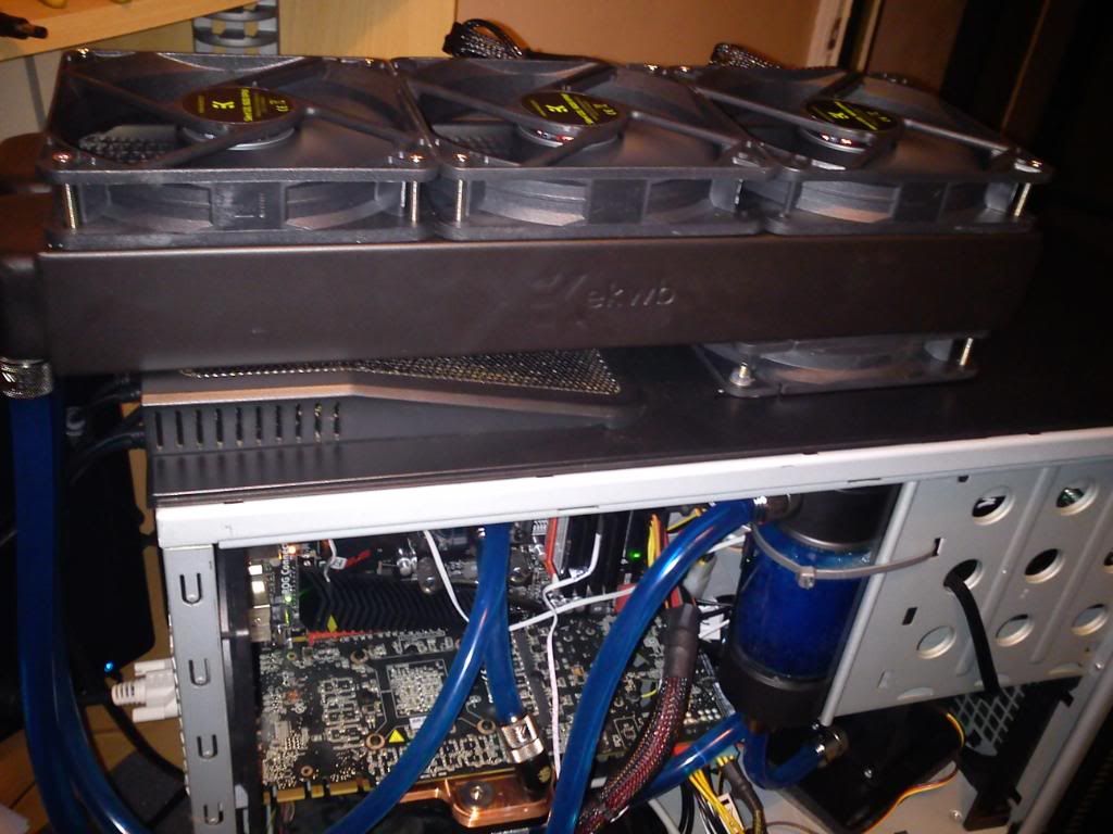

pics as promised, none of the actual building as i wanted to get it finished and it took me ages, also not the greatest quality as i used my phone cam.
and yes Cleeeco that is a copper block on the GPU and you dont like it but its mine so tough :D

Copper:eek:
*swiftly adds to ignore list*
Not even copper plexi... How could you!!
Just needs a little bit of cable management and it'll look the part (apart from the copper acetal ofcourse:p)
What type of error are you getting on the cpu? And I second the cable management.
