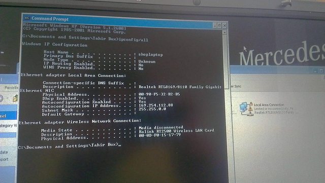

Tried it with a wire that I know is working (the one going to the DVR) and I get the same message. Try to 'repair' the connection but get a message saying an IP address could not be assigned or something along those lines. See below:
Click here for bigger image
You can see the network centre on the right of the image
Same message, keeps saying a cable has been unplugged and limited connectivity. Nobody is moving the cable though
