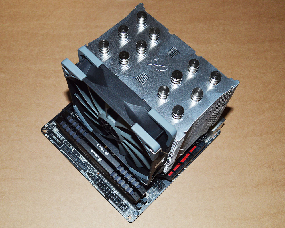

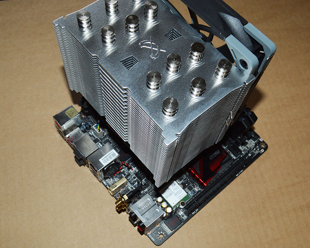

Fits ITX boards fine:
https://www.funkykit.com/reviews/co...ower-cpu-cooler-review/attachment/mugen5_pc1/
https://www.funkykit.com/reviews/co...ower-cpu-cooler-review/attachment/mugen5_pc2/
Here someone crammed Mugen 5 into ITX case with fans in push-pull by turning it 180:
https://imgur.com/r/sffpc/Bb1GIY8
