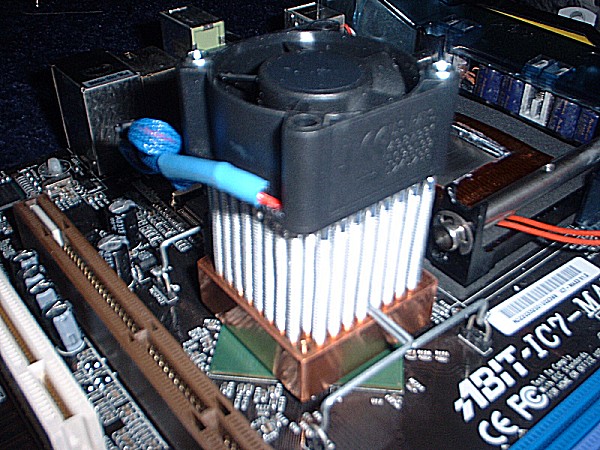

This is the fan its an led one, you just remove the fan from the heatsink.
this is a pic of it installed, if you dont like led ones im sure there are normal ones available
