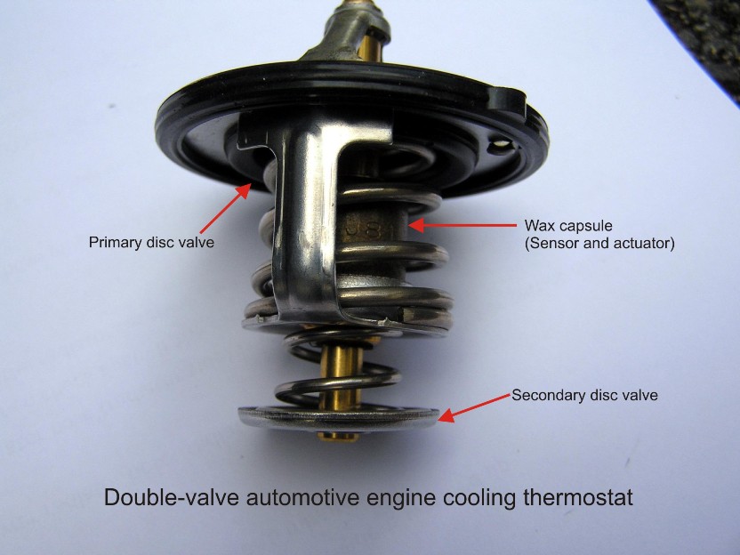

Thermostat (check your temp gauge see if normal range when car heat up), not sure on your car but it is usually a wax filled unit.
