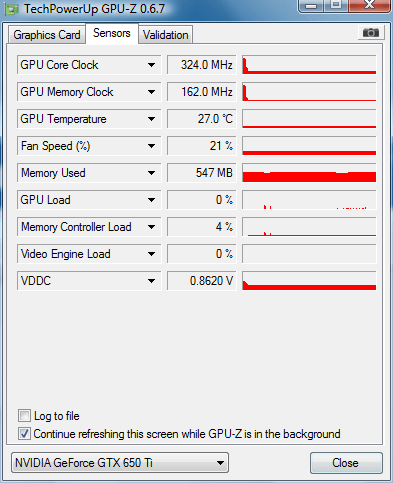

First, check temps. General computer use the graphics card is close to idle, when you fire up a game it starts to take on load so temperatures rise.
You can use GPU-Z to do that, post a screenshot if possible.
See if we can get to the bottom of it, won't be long till the dons swarm the thread :p
If you take a screenshot of the same thing but after a few mins of the card being at 100% load, like while using Furmark or something, it would be a bit more useful. Idle temps dont really tell you anything.
They can to a degree, 27° is pretty low for idle. If it was like 50° idle then it would 100% be a heat issue as that would most likely double during load.
As he states, put some load on the GPU, play one of those games that is causing the lines and then take a screenshot straight away.
The above screen captures were taken while skyrim was playing in the background
If you have a game open but minimized, it isnt putting load on the GPU because the GPU is still not doing anything for it.
Your screenshot says Load:0%
Use furmark and it will put full load on your GPU and show you the temperature you are trying to find out aswell.
