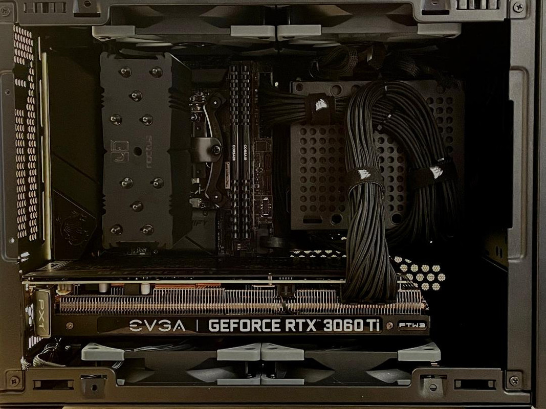

Been browsing for a while, but just now reaching the end stages of my very own NR200 build. Debating coolers currently (FUMA2 or U12S), but below is a snapshot I had to take when test fitting my U12S. I'm proud of my work so far and thought this a great crowd to share it.
EDIT: Oh boy, apparently I don't know how to upload photos... https://imgur.com/a/9Hx3Gl0 is what I'm trying for here...
9Hx3Gl0
9Hx3Gl0
9Hx3Gl0
9Hx3Gl0
9Hx3Gl0
9Hx3Gl0
DOes the U12S fit with the Tempered Glass panel on or is it only with the vented side panel?
